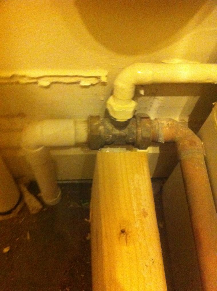

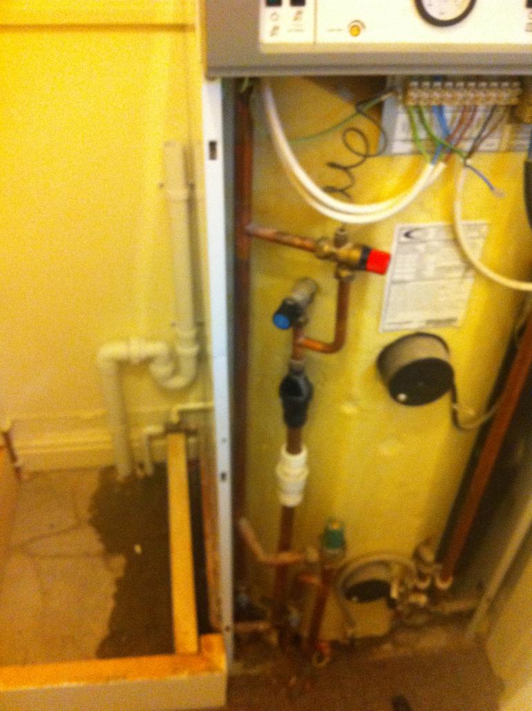

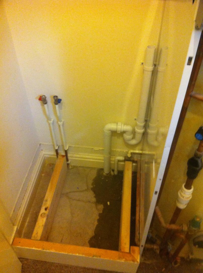

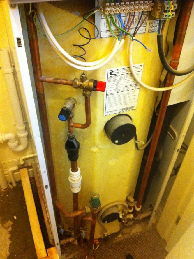

i was servicing this unvented cylinder today, on testing the t+p water appeared from the plinth at the side so i removed the plinth and found the d2 pipework connected to overflow pipe! this was also where it was leaking, there are a few other issues no tundish on prv discharge, trap within 300mm on d2, i failed it due to these issues but when i tested the t+p discharge before i even noticed it leaking it backed up and caused the tundish to spill, my question is would you have failed it on this basis alone without the other faults or just note it as a default and advise to have it rectified i dont do many but this is the first one ive had thats spilled, cheers

ive now got the job of putting the cylinder right well cylinders because it turns out that all 6 flats have been run this way, im going to use the hepvo tundish adaptor kit can anyone tell me what fitting i need to get me from the hepvo to 22mm copper and from this into 4" waste, is there a strap on boss that will take 22mm copper?
ive not traced the current d2 yet but im just thinking there might not be enough room to run 32mm down the same route as the current d2 if but if there is then i will use 32mm polypropylene
