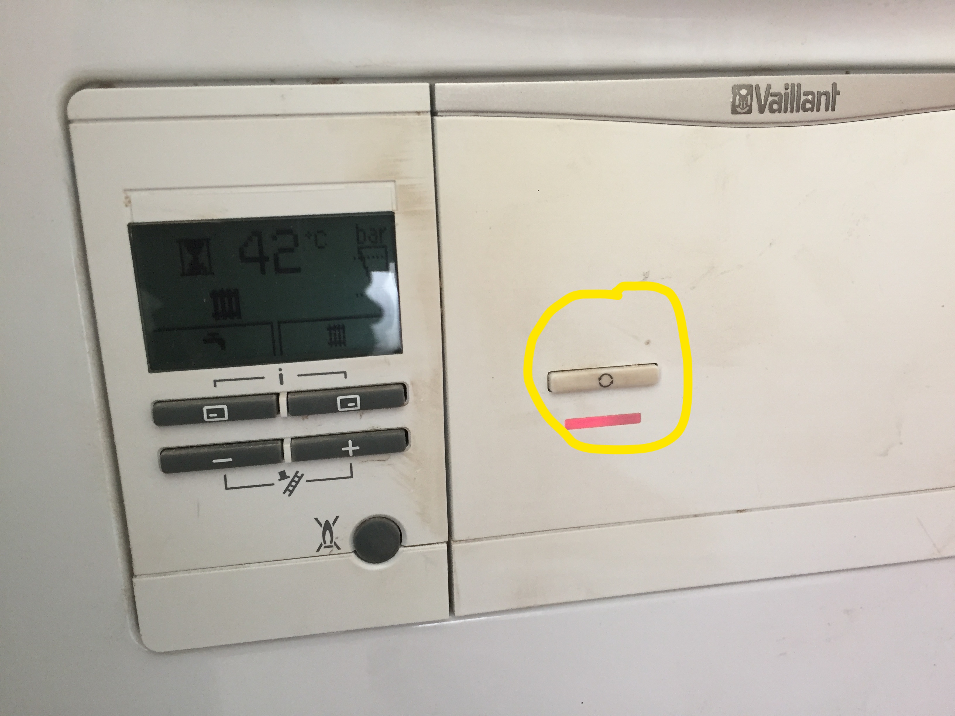

Also I've attached a picture, can someone tell me what the button on the front is. It is always showing red, but if I press it then it flashes amber.
I have read on a forum about the possibility of the wireless thermostat receiver being wired into the boiler incorrectly. Could this cause the problem of boiler coming on all the time even though it's supposed to be off, or the anti cycling mode always coming on?

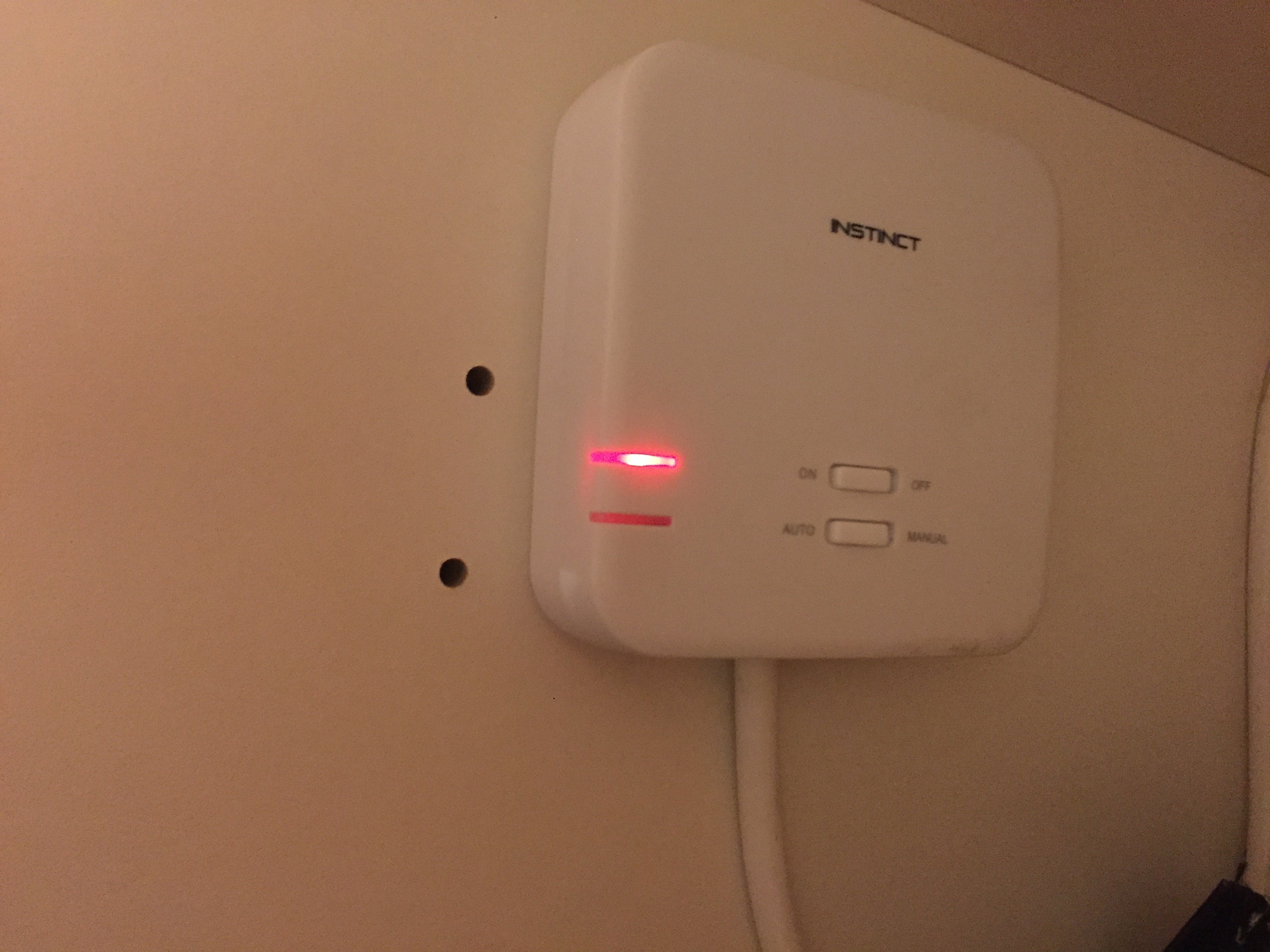

We are the first people to live in the house since it has been refurbished so it may not have been tested properly. Someone else has pointed out to me that the part with the button on I was referring to is a vaillant receiver. But there is also an instinct instrt520rf thermostat installed. I’m wondering if the fact the old vaillant receiver hasn’t been removed is causing some issues.
Re the towel radiator, i have bled it and water comes out, so strange that the hot water isn’t getting through.
Looks like you have a vaillant wireless thermostat?
Well I now know that what you are referring to is the vaillant receiver. As above, the vaillant thermostat isn’t present but there is a new thermostat and receiver wired in.

Problem solved, was indeed incorrectly wired in the first place!
Thanks for everyone’s help.
Will tackle the towel radiator another time though!
Reactions: Chuck
Coincidentally we had a massive leak from one of the pipes under the floor yesterday (luckily to ground). The plumber that did the original install came to sort it. (well it was his workers but he came to sort it). An incorrectly push fit had popped off and water was flowing through the boiler and straight out to ground!! He had to remove kitchen cupboards, cut a hole in the floor and climb down through the smallest of holes and repair the pipe. Whilst he was there he rewired the thermostat. It was wrong in the receiver and the boiler! Now working and with the heating coming on this morning, it has cleared the blockage in the towel radiator and this is working too. So all sorted now! Luckily no damage apart from the hole in the floor, but this is underneath kitchen cupboards so you wouldn't know.
