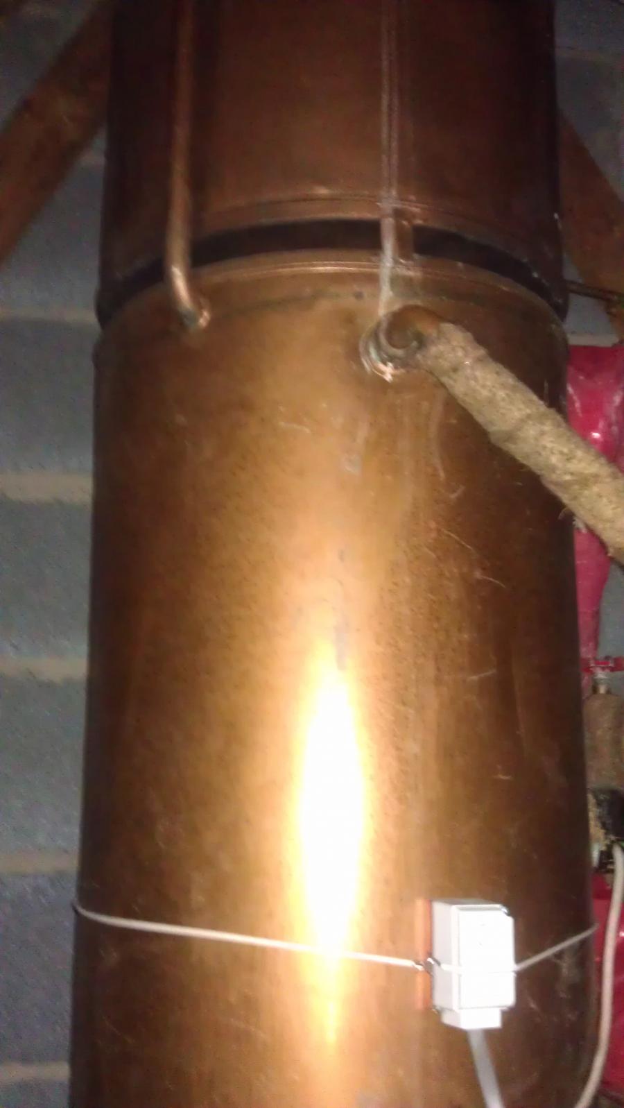

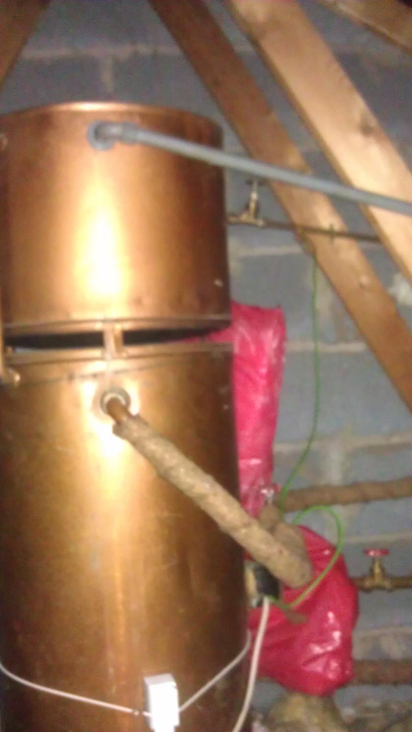

Thanks for the replies. Maybe my information on it being a primatic cylinder was somewhat wide off the mark judging by the incredulous replies! I've attached some photos of the offending cylinder.

blimey that is an old beast i realy couldnt say with any certanty its not primatic seeing the size of the tank on top
does the tank on top supply cold down service as well ? have you any other tanks where in the country are you ?
'i d love you to say morth london but cant see it
