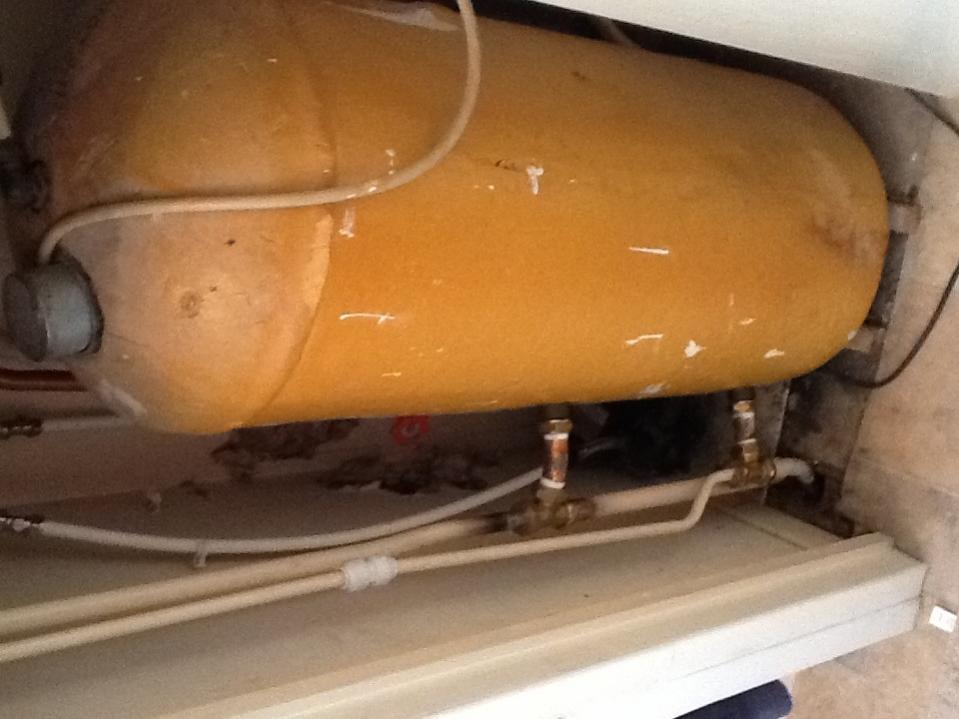

Can you post a pic of the HW cylinder and associated pipework? (general view, not close-ups)
Sorry, can't rotate on iPad. 🙁 -
15mm coupler and clean pieces of 22mm was me clearing magnetic areas of pipework while trying to fix this issue.

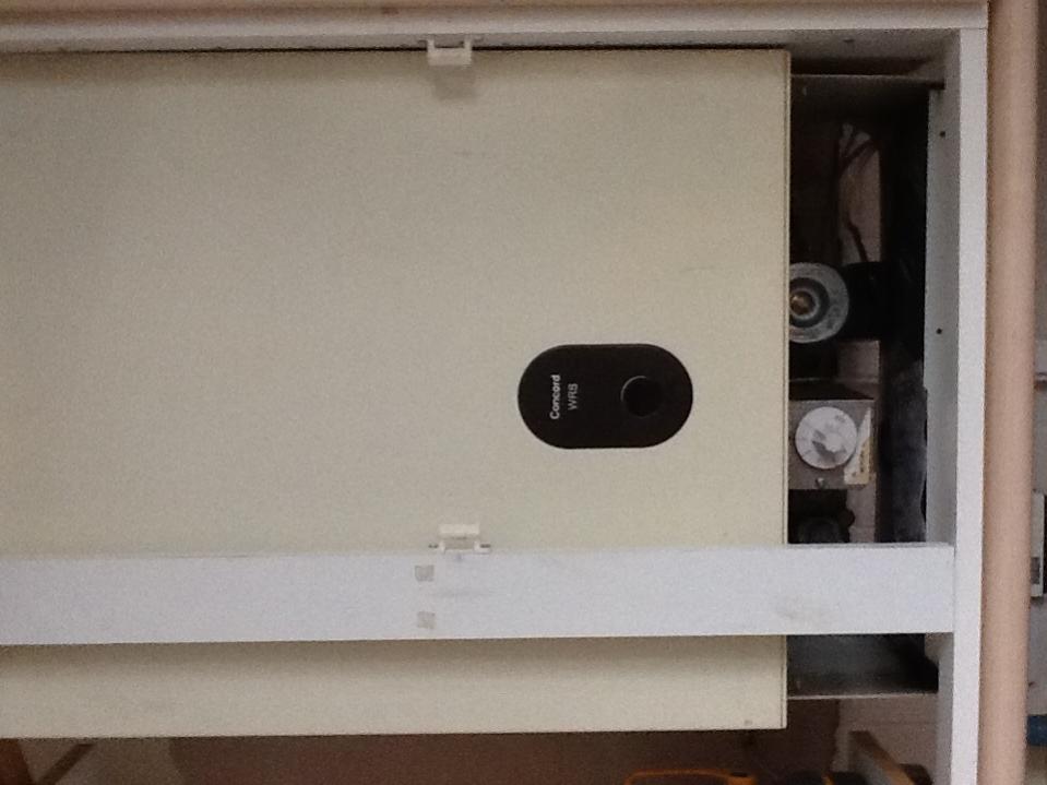

A pic of the boiler and pipework would also help, so would make and model of boiler if not obvious from the pic.
Concorde Ideal WRS 230A
