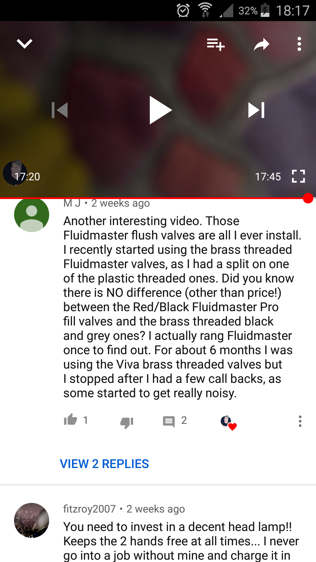

Screenshot_2019-08-03-18-17-58.pngfrom comments on Dr. Pipe YouTube - mentions noisy. But nothing else.

View attachment 39830from comments on Dr. Pipe YouTube - mentions noisy. But nothing else.
Interesting. I found my new Torbeck Ecofil to be slightly noiser than the Viva. Probably depends on water pressure too. That said, the access and maintenance of the Torbeck is far easier, but we all have our favourites.
