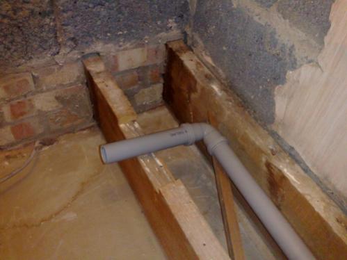

I'm just about to put down my final bit of flooring that occupies the bath area. My waste pipe will come up through the floor but I'm a bit unsure of how it will run to the bath.
The attached two photos show the proposed two routes. The first photo (ending 303R.jpg) would see the pipe exit and travel horizontally from the 90 degree bend. If it was done like this then the horizontal pipe would run at an angle to allow a fall. Would this then connect into the bath trap correctly if it is running at an angle?

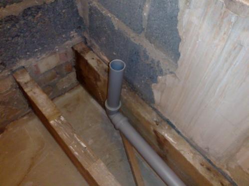

The second photo (ending 304R.jpg) exits vertically. If you ignore the length of the pipe that's in the 90 degree bend as that's just there for the pic. I was then thinking a small amount of vertical pipe, then another 90 degree bend on top which would then take the horizontal run to the bath trap.

As per second photo, but dont try and be clever and to precise, best to keep the vertical piece of pipe away from trap as much as possible to allow room to play with for the next elbow, pipe and trap.
