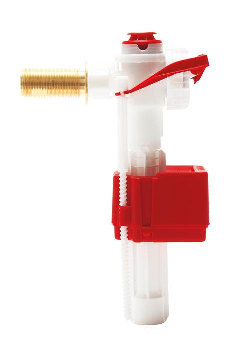

Plumber came out and not so happy with the work. I didn't get the valve as suggested here and let them supply one. They turned up they had was the wrong size valve and went to get another one. Basically they've replaced the valve with one that looks identical which after posting on here is a surprise. Noticed the water level was lower now, but no boucing ballcock so good there. However now when the bath runs you hear a strained noise coming from the valve which has an affect to act like water hammer. It also dribbles for ages when it's filling back up. Groan.
