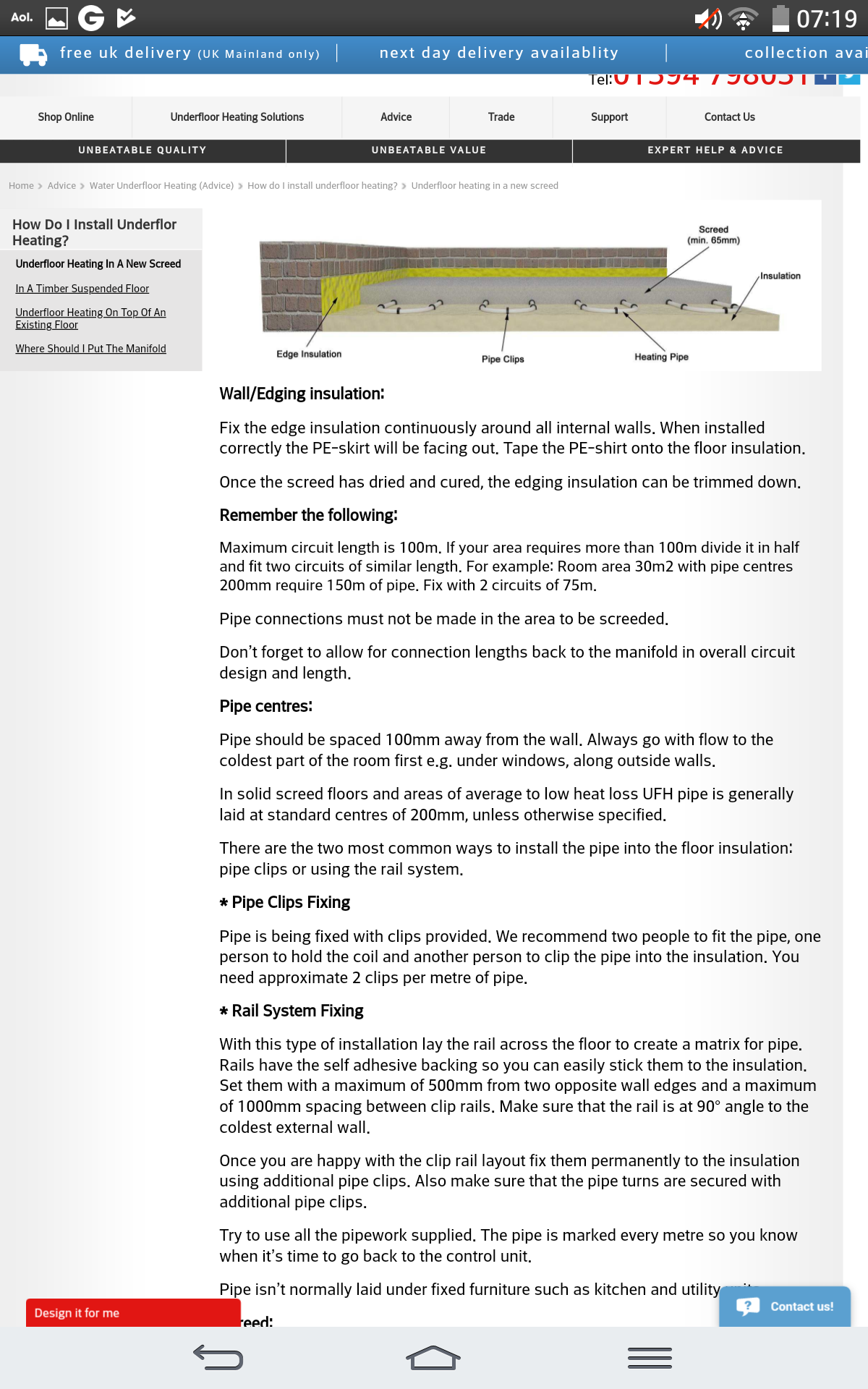

This will give you some idea Dale dont put any loops under where you have kitchen units , and as shaun said check with building control on insulation installation . cheers kop
