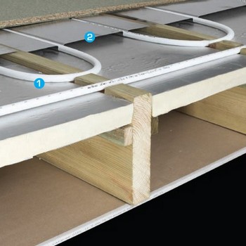

but in essence the old part was suspended, so the pipes we're left as they were, clipped to the Cellotex, and then the chipboard floor was put on top (with the new flooring to be laid on top of the chipboard) - with no screed of any kind, just the air.
Like this?
How thick was the celotex used on the screed and joists?

its a real p poor install. the suspended part should have either spreader plates or a screed between celotex and timber floor.
