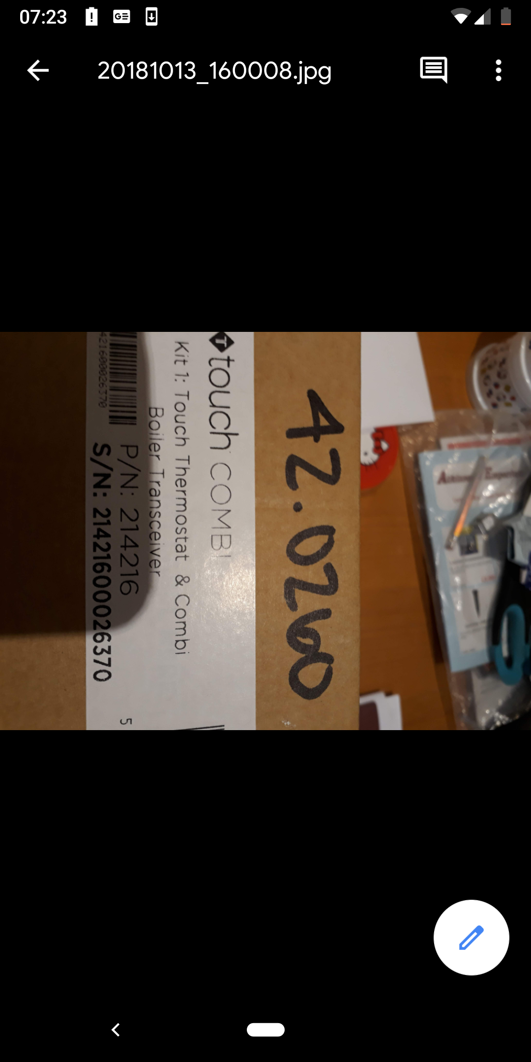

The Vogue has its own Wireless programmable thermostat called the touch I fitted one December 2018 and has worked faultlessly so far I personally would not pair the boiler with a esi control, but saying that I would also be advising you to stick a with unvented cylinder and new boiler, even a 40kw combi will not supply any where near the amount of hotwater that a cylinder will and with 3bar incoming pressure and flow behind it will supply both your showers easily, I think go for the vogue system boiler and upgrade the cylinder I dont think there will be much in it money wise all the pipework is there just needs reconfiguring all the best . Kop
