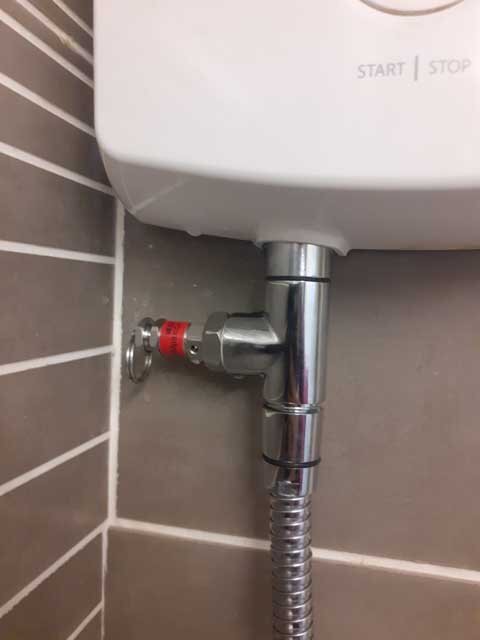

Sorry for the delay in updating this discussion, I have been waiting for delivery of a simple PRV I found online. I now have the new test valve in place in the 90deg arm of a three way fitting connected between the electric shower outlet and the hose. Note that that in no way affects the original internal PRV action. All parts are in chrome so it looks a tidy and integral part of the shower unit.
As you advised my overhead rain shower unit with a separate handheld hose and head was not intended to be used with an electric unit as there is a dead spot between the two on the selector knob. This means that flow would be stopped for a fraction when switching. This is an obvious genuine safety issue if it were to be left in that no-flow position. Hence as you say all units are fitted with some form of trip valve fitted into the heater unit. But why a one shot device which has to be replaced every time it trips? My own Gainsborough heater has a ball type, currently £15 if you fit it yourself, and it had popped on the occasion I first became aware of this whole issue. I then learned of the problem and the requirement to not use this type of shower setup with an electric heater. However, if we fix this issue then surely there is no reason why not.
The new release valve is a 0.5bar metal type looking a bit like a whistle. Thanks John.G for the 1.38bar benchmark, it was a great guideline. To my eyes it works perfectly! It does not leak at all during normal use and on changeover from head to head it now gives a short spurt as the selector crosses the dead spot and it releases the pressure. There is absolutely no need to transfer with any haste, even if set fixed halfway so no water flows out of either head it easily vents enough water to not trip the internal PRV. It makes obvious sense to ensure you orientate it so it vents somewhere it can drain away cleanly, mine is onto the wall tiles and down into the bath.
I've added a pic of it in place and a vid of it working. You can see the spurt as I slowly swap from head to head. I do mean "deliberately slowly". Normal natural swapping action is much faster than this. You can see I did the changeover slower and slower to force the valve into action to show it releases enough pressure to do its job. I would welcome your thoughts on this as a solution. Remember, the original internal PRV protection is not affected in any way so all designed in safety precautions should be preserved!

If you select maximum flow, temperature control to minimum, does that 0.5bar PRV still stay closed?.
What is the shower power output?.
The shower is a Gainsborough 10.5 SE which has only a single temperature control with no switching of multiple elements. I do realise that the temperature is set purely by adjusting the flow rate internally so the lowest temperature incurs the highest flow rate and pressure. I have already found that when the temperature is almost all the way down, maybe only on about 20% and below, the valve does open prematurely. It isn't a huge gush, just a fair sized trickle. However, I did buy another 1bar valve exactly the same as the one I have just fitted which I will try to fit.
These valves are standard BSP fitting, (1/8"), and a few turns of PTFE tape meant they only had to be fitted hand tight to be water tight at the joint. So swapping is very easy.
As I keep a spare internal PRV on hand it won't matter too much if it blows during testing but as I said, having this system in place doesn't affect the action of that internal valve in any way, it certainly doesn't increase pressure, so it really shouldn't be needed. I did want to start with the lowest pressure valve I could source as I wasn't sure of the setting of my own model's internal valve and I had no idea of the working pressure at the outlet of the heater. As you pointed out the 1.38bar unit you knew of I took that as my starting reference. I'll fit the other 1bar valve later today when I get a minute and test that.
Just fitted the 1bar unit. It is definitely much better. It still drips slightly at the lowest temperature setting which is actually quite reassuring but it is now a lot less than before and only at the very lowest temperature setting. The action is exactly the same as before with full relief even when the selector is locked in the mid position and offers no flow out of the rain head or handheld head. I'm sticking with this one. The type I used can be seen here: AliExpress example of PRV. Granted this is a Chinese site and there will doubtless be some who won't buy from there but it at least shows what is available if you can find it in this country. Here is why I have no qualms buying from China direct: Amazon version. £4.40 delivered v £45.35? No contest!
Incidentally, apologies for incorrect information earlier, I said I used a 1/8" version which was wrong. It was the 1/4" version I bought fitted into a 1/2"M-1/4"F adaptor.

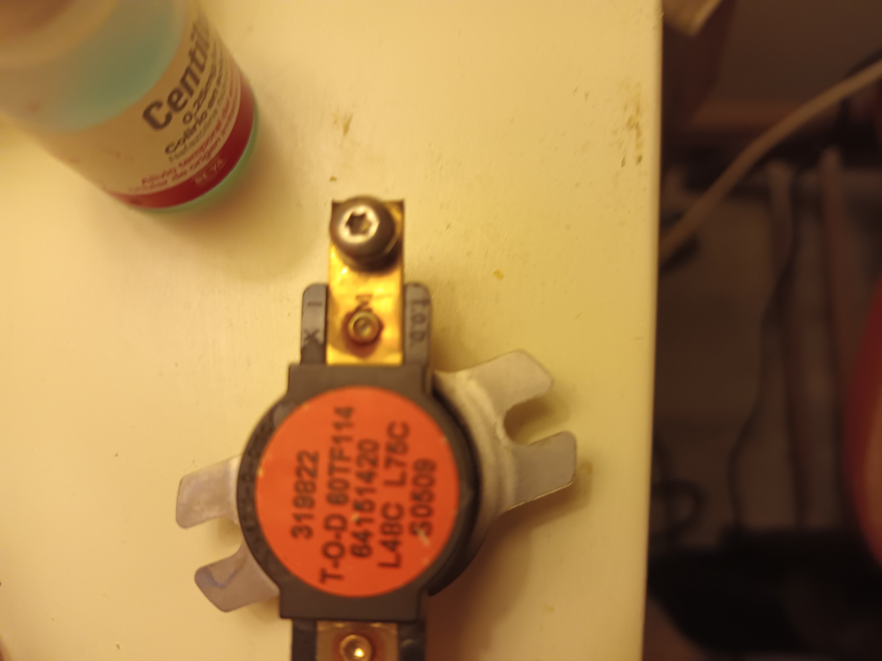

Electric showers are designed to give their rated flowrate at a 1.0bar dP so not surprising that the 0.5bar PRV is lifting. All showers also have a dual temperature thermal cut out, TCO, the first (Triton&Mira) stat operates at 48C and self resets, the second, at 75C, does not reset and the TCO must be replaced.
My present mains temp is 17C.
A 10.5kW shower flowrate will have to fall to, 10.5*860/60/(48-17), 4.86, say 5.0LPM before the 48C TCO kills the power to the heating element with that mains temp. At a fairly typical 40C showering temp, the flowrate must be, 10.5*860/60/(40-17), 6.54LPM.
I would expect the rated flowrate of that shower to be ~ 9LPM at a dP of 1.0bar.
It would be interesting if you measured the shower flowrate, outlet temperature and mains temperature when the 1.0bar PRV just starts feathering (lifting), that will give a good idea of the condition of the heating can, scaling etc.
