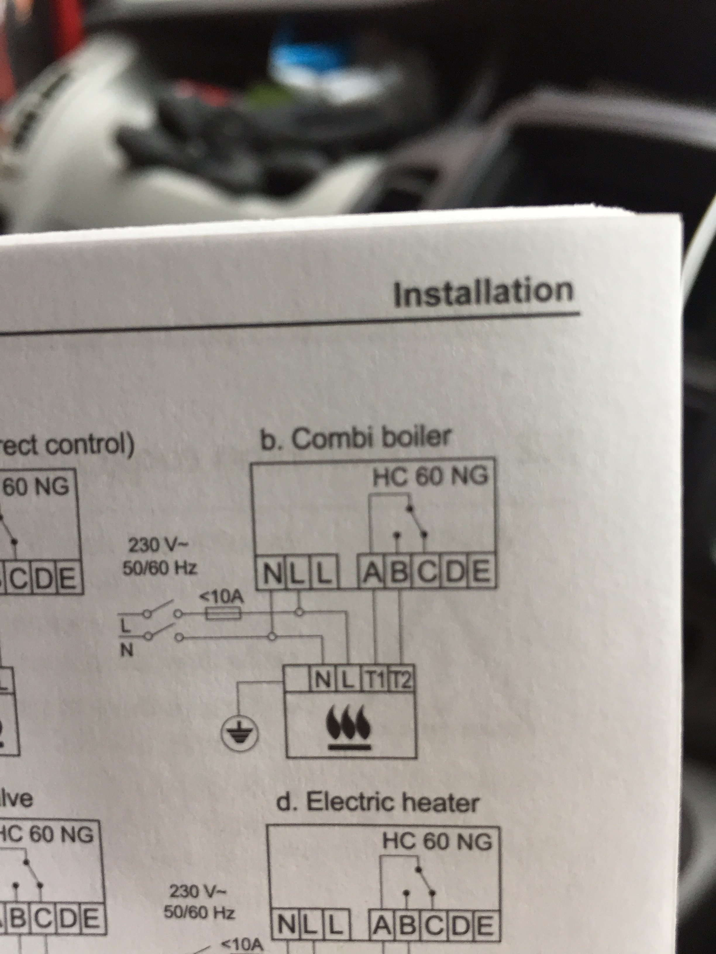

Alright guys. I’m just putting the feelers out ready for tomorrow here folks. I’ve gotta fit a Honeywell wireless stat to a Vokera boiler. I have no experience with either so may need a little help. Cheers guys. Hopefully it’s just a live, neutral and switch live.
Depends which Vokera, one of the new ones you need to disconnect the switching pair from the plug-in timer.
Is it boiler+ compliant 🙂
Normally Honeywell are
Live
Neutral
Live (normally link from l live to here)
Then switch
You know me mate. Wiring for dummies ha.
You’ve lost me with this ?
Macka,
I think all the advice you need is there.
I would only add that Vokera are not consistent with their boiler control philosophy - they seem to develop / evolve it even within the same range.
Read the MI’s for the model you are working on twice before connecting - the pcb’s are very intolerant of the wrong voltage across connections.
Weather compensation is often through a relay ( to create a second channel for hot water control), that is not present on the early models
Good luck
I got it done chaps thanks. As the new receiver was plastic I didn’t have an earth port so just cut them back and taped. All working fine. Thanks again
