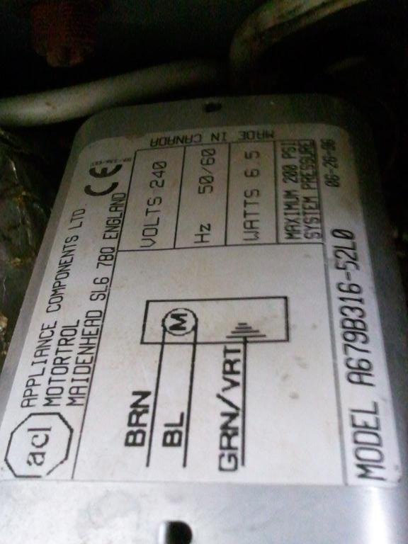

OK chaps - it is an ACL unit. A679B316-52L0 is the number I can see.
Any chance of explaining what you mean ref. the head and the paddle? Should I lever/clip off the metal cover to see what it's like underneath? Should I be able to see the cogs inside then or does it all need removing from the boiler?

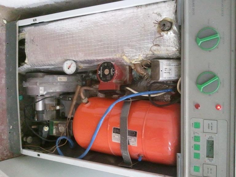

Here are a few pics - as you can, she doesn't look like the most well loved boiler ever 🙁 Photo1371A.JPGPhoto1372A.JPGPhoto1381A.JPG
