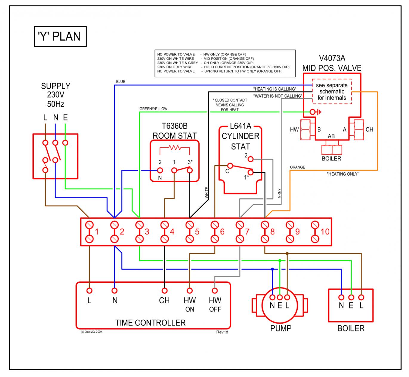

Have you fitted the new valve the right way round?
A . Is heating
B. Is hot water
Hi Chalked
i have B going to my hot water tank next to port valve in my airing cupboard and A to pipes i assume feeding my central heating rads. but as i said the 3 port valve is not yet wired up i thought the lever on side could do everything but ive now been told that the programmer has to talk to the 3 port valve which at mo is not happening. if this is indeed the case i may have no problem and it will work when wired up?
cheers
paul
I should have read you first post
It's not wired up!!
Moving the lever manually will not make the end switch Fire the boiler. All will be fine once it's wired properly.
note wire colors may differ to your 3 port
HI all that have advised me on 3 port valve problem thanks for all your help at least now i know it has to be wired for the ch part to work..u have all saved me alot of stress thanks agn guys..
