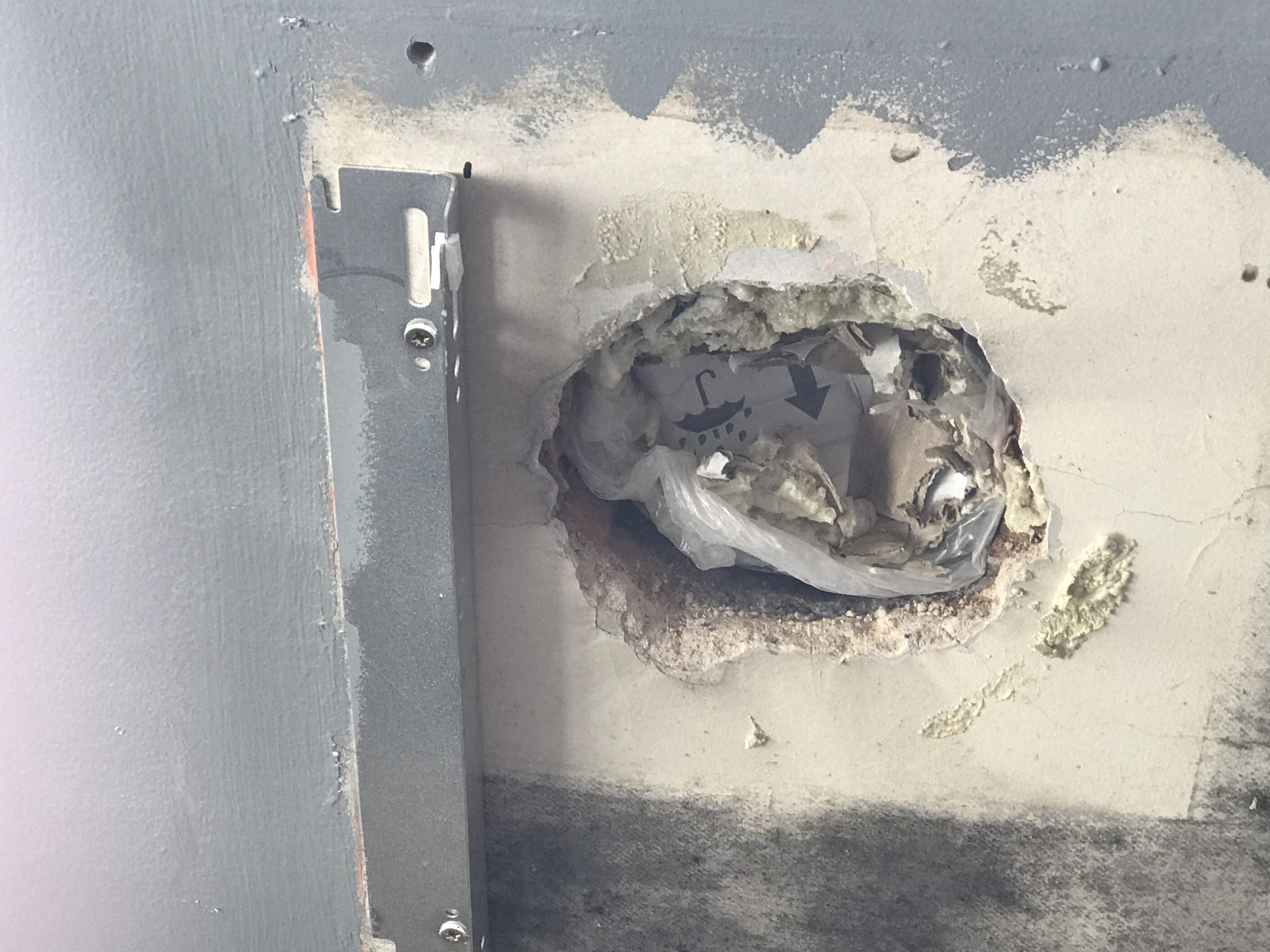

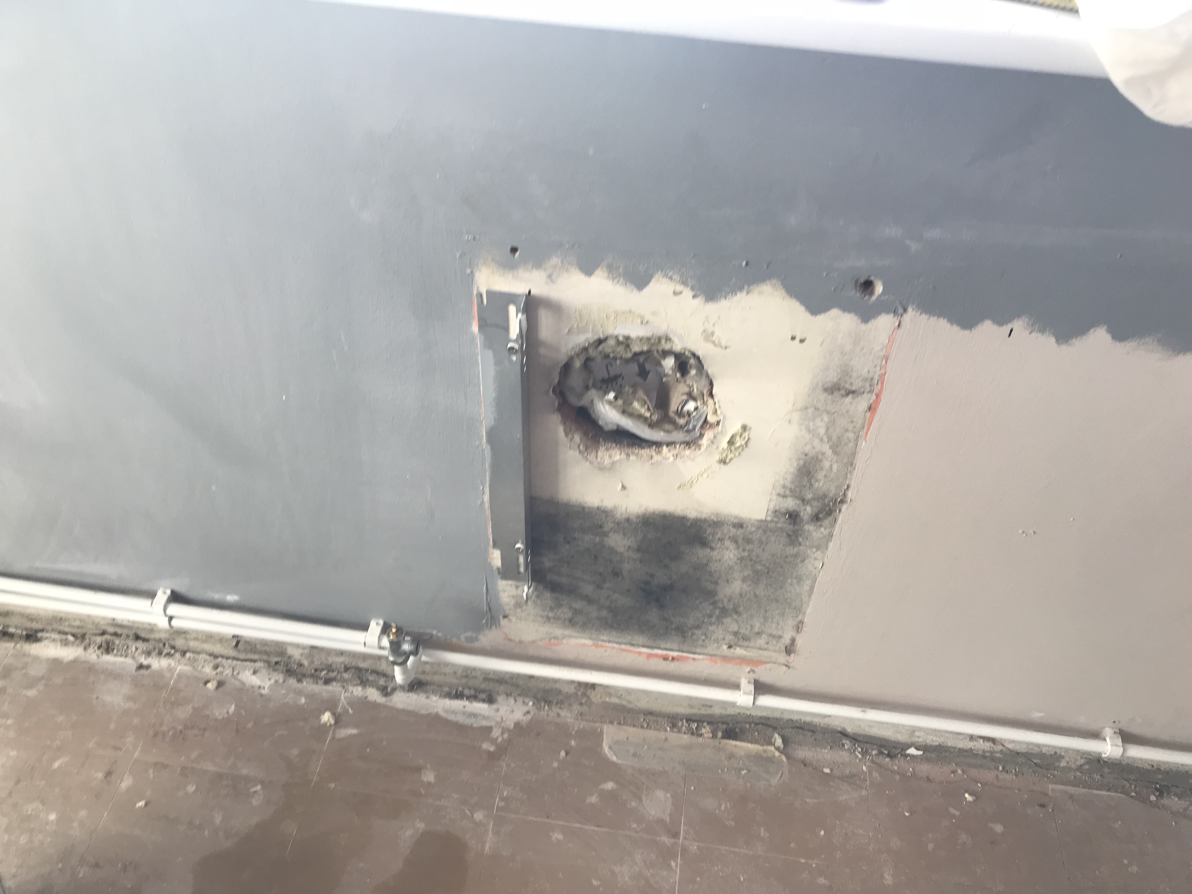

The 2 pictures of the hole is
Where I had taken one of the reads off to plaster. He had just left the hole in the wall where the old heater was. Same in the other bedroom.

The holes in the wall are obviously not on.
