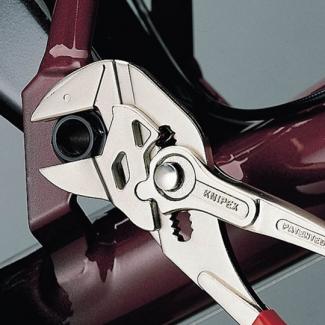

I highly recommend the Knipex smooth jaw wrench.
The jaws are parallel opening, but most importantly is they keep tightening against the nut as you use pressure on the handles. Excellent for chromed valves and the brass tap glands.
It was Jaytheplumber who on this forum I think first let me know about it
This is one I got, 250mm model, but you need to choose the right size for your jobs, or buy a set. They are a bit bulky at the jaw end, although are also fairly slim there.

I know I am a snob but be like me and get into the modern age with a Knipex self constantly tightening smooth jaw spanner.

The Knipex spanner just doesn't move on the fittings/nuts and shouldn't slip. That means it also shouldn't slide to the side of a fitting/nut and angle and slip off sideways. It also lets you 'grip' a fitting to hold into position like set of grips can do. And you can manually ratchet it.
Early days with the Knipex for me, but I find I always reach for it with some fittings and tap works. Trouble is it is yet another expensive tool cramming the tool box and making it heavier.
