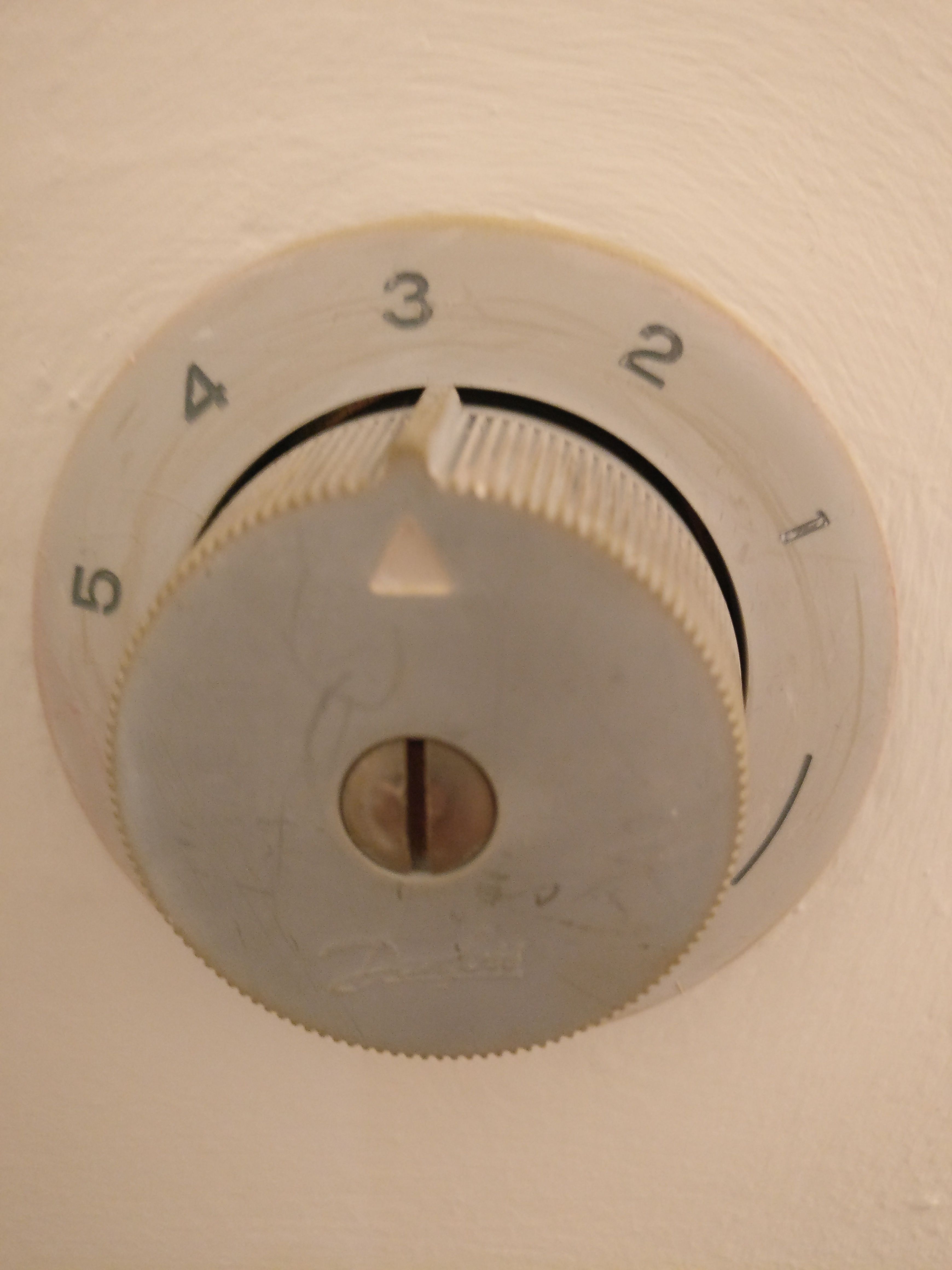

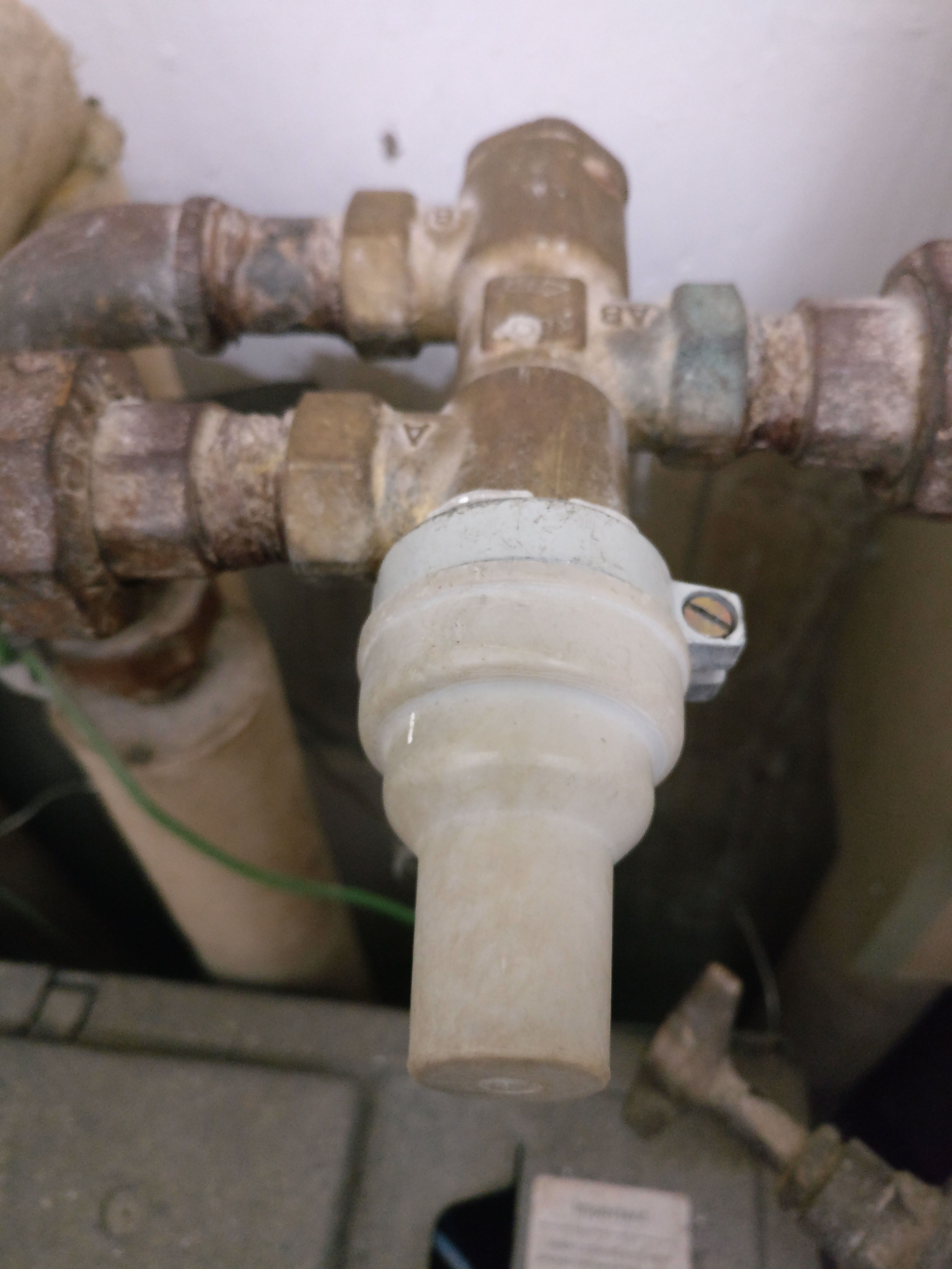

The problem looks as if it is with the 'regulator' (no idea if that's the right word) - which is connected to a Danfoss control knob in the hall marked 1 to 5 via long length of unsheathed flexible metal wire - which doesn't look as if carries a current. The hot water is reaching the 'regulator' (ie pipework is very hot up to it) but not going beyond - whichever way the control knob points. Basically I'd like to figure out if there's a way of opening this device all the time so that hot water will flow around the system whenever the stop valve is open.
First pic shows the 'regulator' in situ, the second removed from the device, the third the control knob.
Thanks guys and gals.
it is a mixing valve and mixes the flow and return to set a desired temp if you have always kept it closed the pin may have stuck just tap the pin gently with a pair of pliers and see if it pops out be careful not to pull the pin out though a it may leak. if still no joy get your landlord to send someone out to look at it
