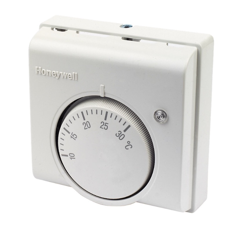

For want of knowledge, I've set flow at 75C on boiler, but don't have figure for return. There is no bypass fitted, but it seems a requirement in the installation manual (just readin up🙂 ). I guess Installer thought the nearby bathroom towel rad would do (?). There is a new Honeywell 3 wire stat in the Lounge. Old one was original Honeywell fitted donkeys yrs ago and plastic was smacked about. New one is the updated version, a T6360B ...
View attachment 32739I'll report back on performance tomorrow. Thoughts and ideas most welcome !

Stat in lounge? Is it a case of lounge getting up to temp and other rooms aren't?
Hi - good thought - that's why the replacement stat I put in has the handy demand lamp in it so I can keep my eye on it 🙂 .
The boiler cycling still occurs when demand is constantly applied.
As it's a regular boiler my concern would be if the stat is in lounge (with TRV) they'd be no interlock.
