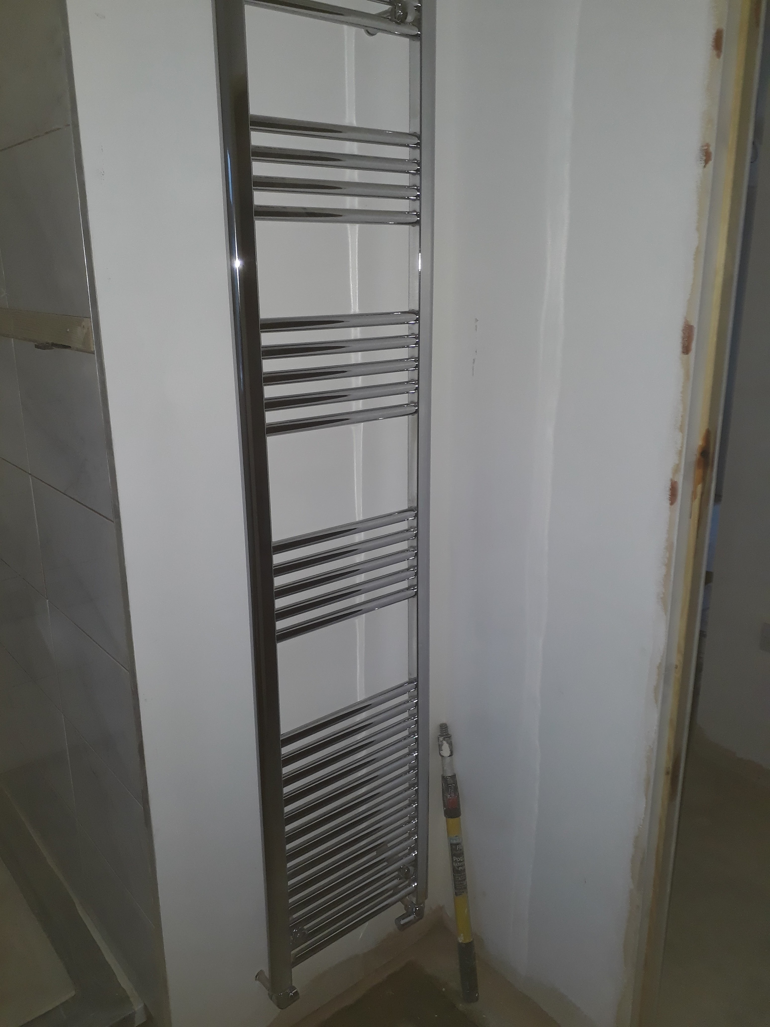

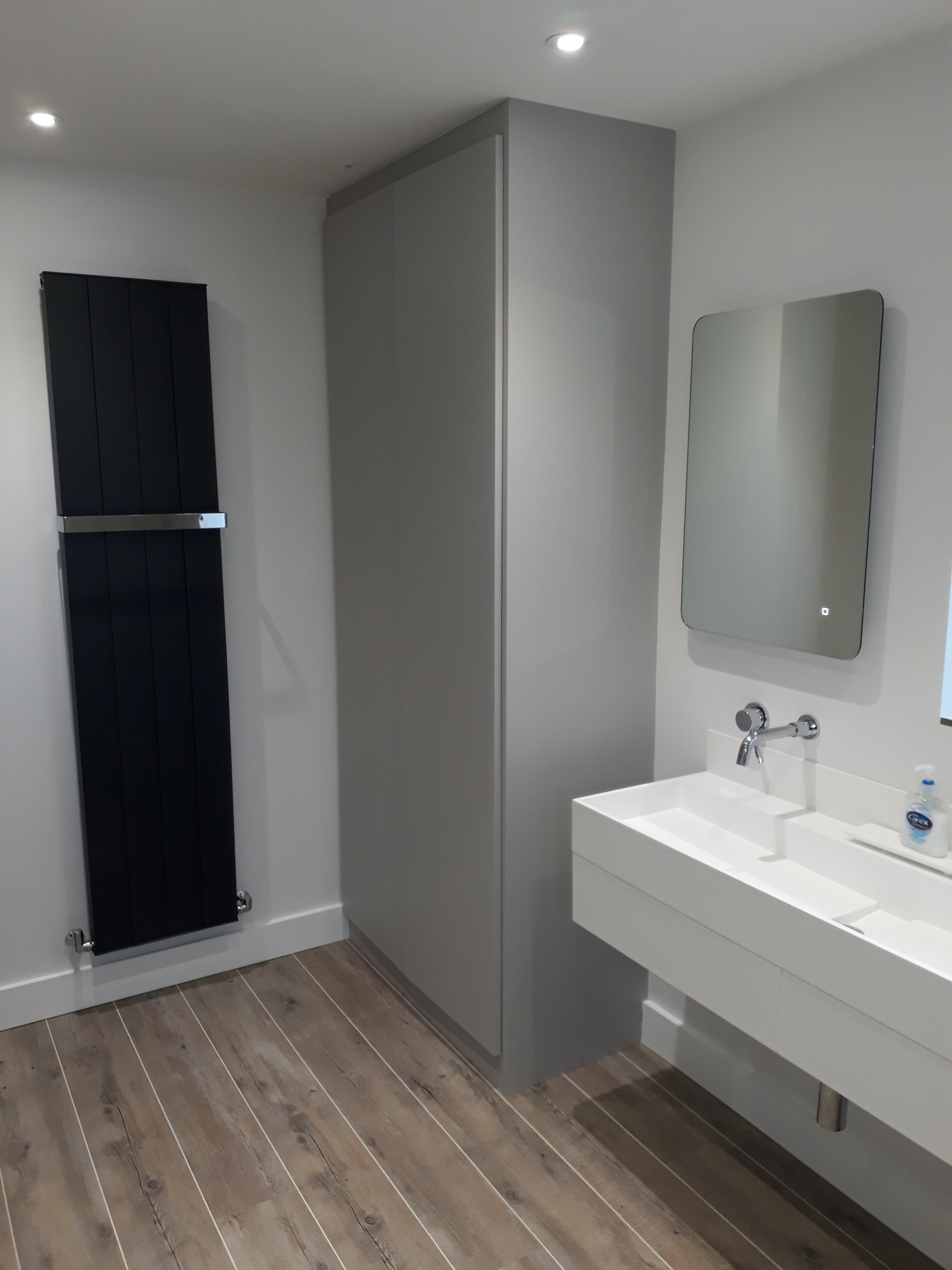

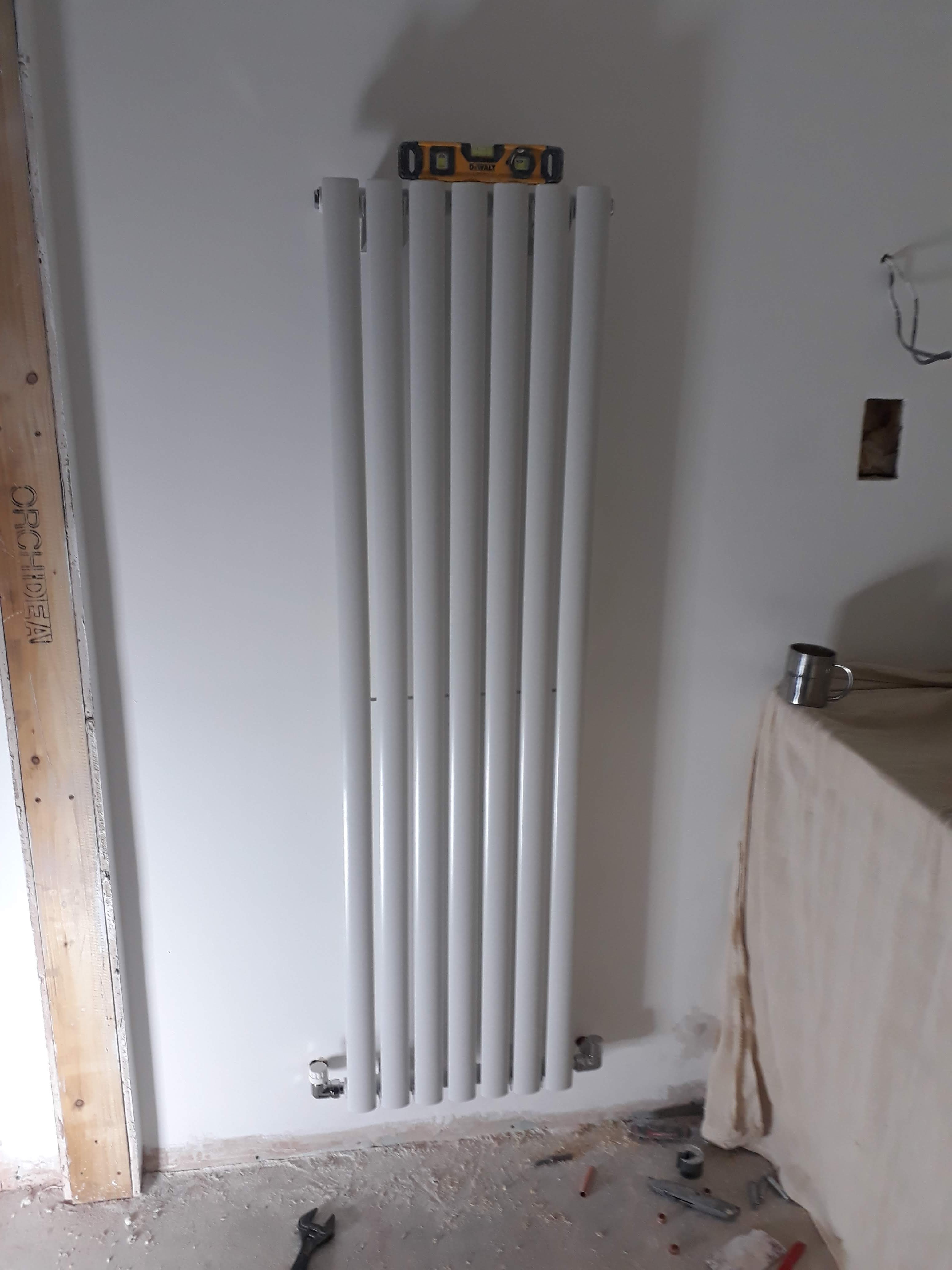

Chop the pipes in the wall and bring them out at the rad valve centres something like this. Kop

I will channel them into the wall like the photos King of Pipes has posted. Nice finish!
