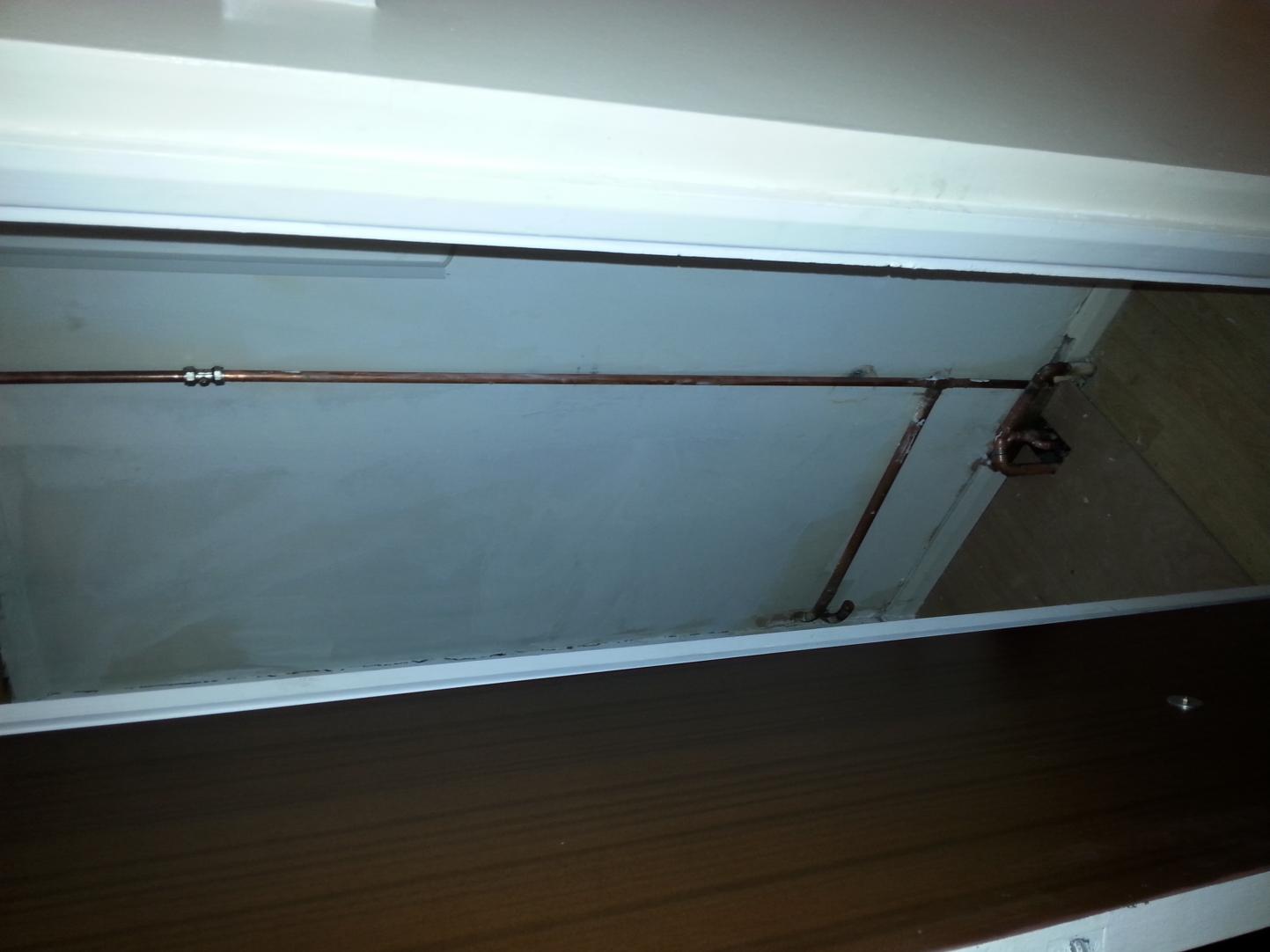

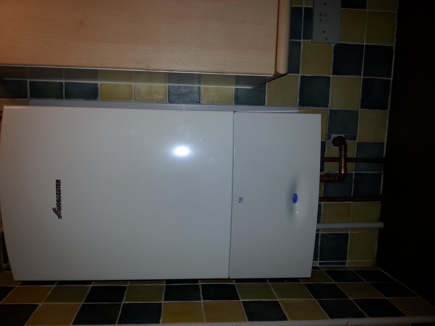

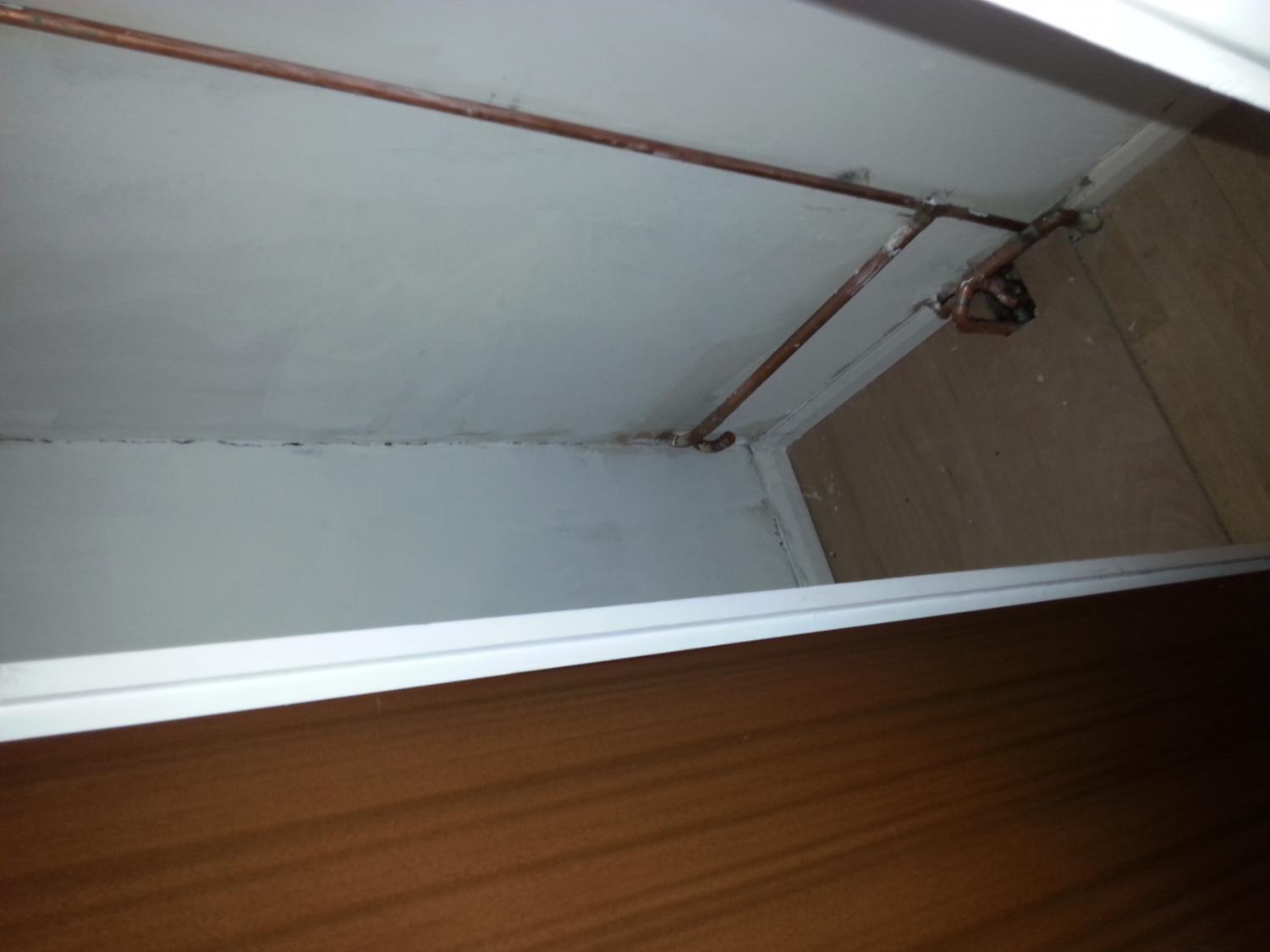

Y Plan to combi. drain and rip out existing boiler, remove tiles so new boiler fits, brick up internal flue hole. Drill new flue hole. washing machine and cooker has to come out numerous times to access stopcock and complete pipework below worktop. Worcester 24i jr hung and piped up. Hot, cold and condense drilled through worktop. gas pipe altered. F+E isolated and removed, cylinder left in for hot water for as long as necessary. cylinder removed, pipework in airing cupboard altered to suit combi. all redundant pipework from airing cupboard removed. tanks removed including numerous trips in and out of loft to remove everything and empty dregs of CWS tank. (no boards in ceiling whatsoever) Fill system and test. System cleaner added, redundant switches/sockets blanked, new wireless controls added, trunking added to conceal cable in airing cupboard, new ply added to floor to make good, old clips removed and holes filled. Boiler area made good - tiles cut and replaced where necessary, trim added to boiler area where tiling not suitable. New boiler commissioned, all scrap pipe/cylinder/rubbish removed with van a bit of a trek away.On your own how long?. Not a massive Property 1 bed house with 4 large rads. Easy for some but first y plan to combi done by myself. Pics coming.

20141022_112525.jpg20141021_145538.jpg20141021_154758.jpg20141021_145449.jpg Before. Sorry unable to rotate pictures.
