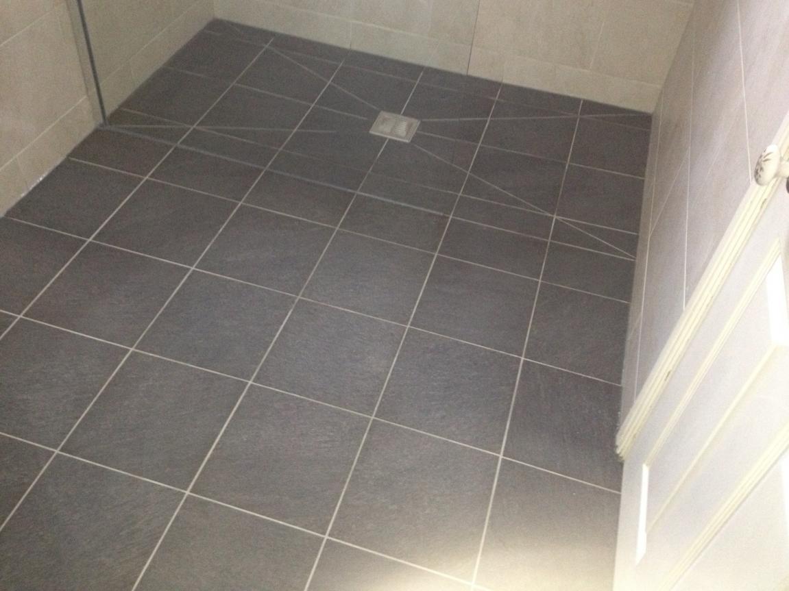

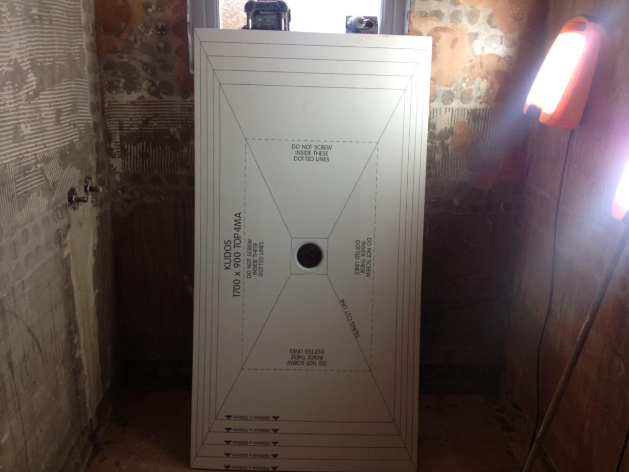

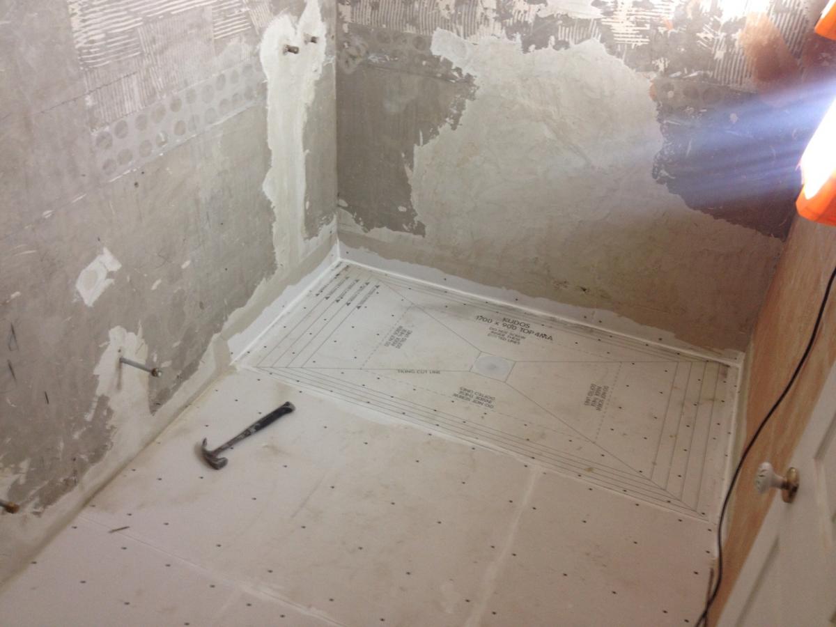

Fitted one last week
tanked the walls with mappai elasagum, bud phone was flat

Looks awesome. Did you build stud walls around the shower tray after or does it just look like that? Also, when tiling, I guess you just follow the llines on tray for your cuts do you?
No mate, didnt build Amy walls. That is the size of the room. With these type of tray formers you can cut them down or add a bit more length.

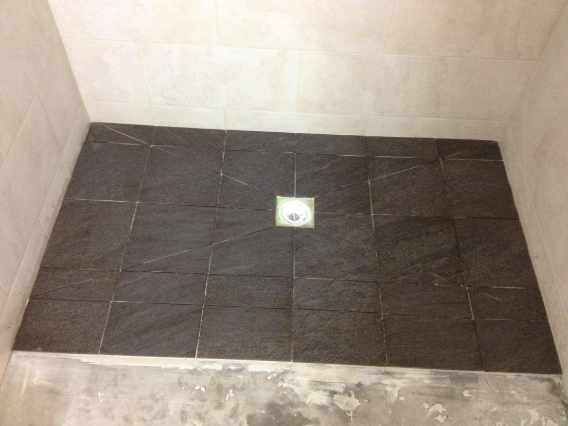

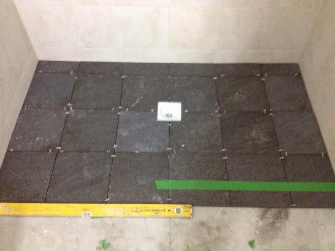

as for the cutting I tend to sit in all the full cut tiles then mark the diagonals with tape, then use a pencil to mark the tape with a straight edge. Then use a wet saw for the cuts, as you need to create a 3 mm joint.

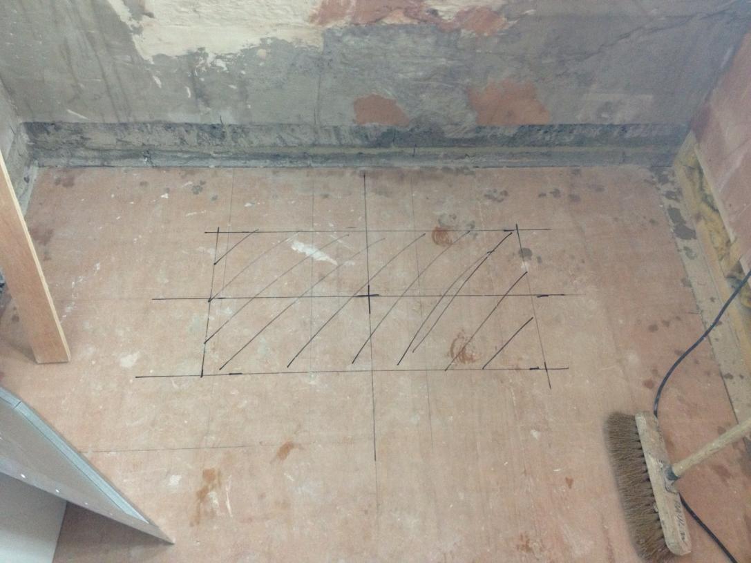

heres the process.
