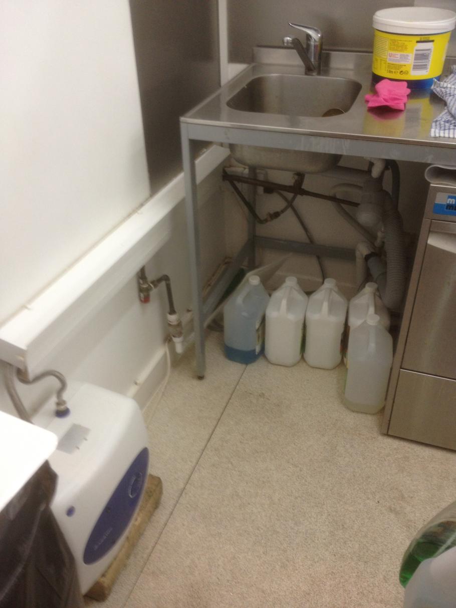

IMG_0092.jpgcurrent location and pipework not how they have put a bin infront of the heater so they dont forget about it when carrying trays in and out past one another. you will also note how moving this heater will allow for the pipework to be tide up especally as its not cliped or supported under the sink
Just had a look don't say it can't be fitted above so that will do me now I can price the job and sort the mess under the sink etc out for them. Sure I can make it look a lot better than that and easer for them clean round
the oversink unit has a swiveling outlet like a tap the undersink unit has to be piped to the hot pipe - if its the 15 litre version it has to follow G3 unvented rules from your pic the unit is fitted with flexis i would not recommend that copper pipe should be used.

Manual says you have to use flexis.
I've never used flexis on one but you should
