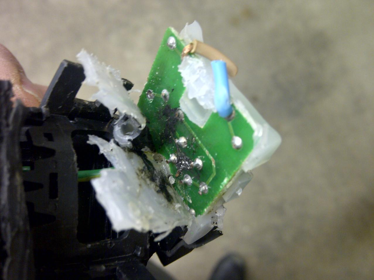

cut old plug open and indeed PCB in there looks like a basic capacitor smoothing circuit for noise suppression, components all black and smelly, got a pic will upload later!

Picture of said plug as promised....toast
