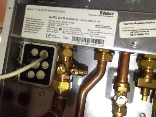

does my gas pipe have a gas test point valve? have attached a photos.
There is no test point installed as far as I can see. How did he re pressurise the exp.vessel ? Did he drain the boiler ? I do not mean the flue gas analysis I mean **** which are certain things to examine, gas rate, integrity of the flue, supply of combustion air,safety controls, etc...
