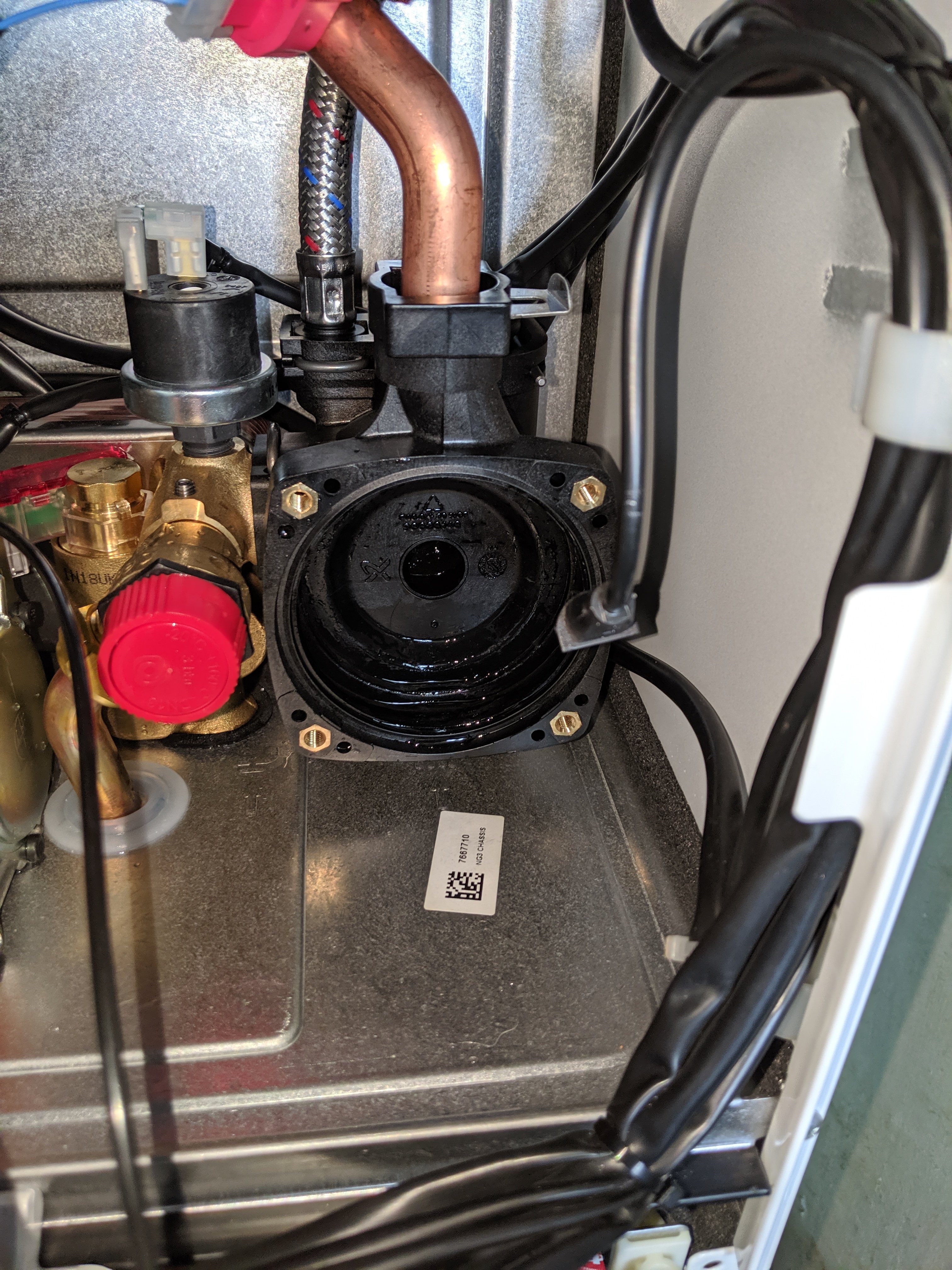

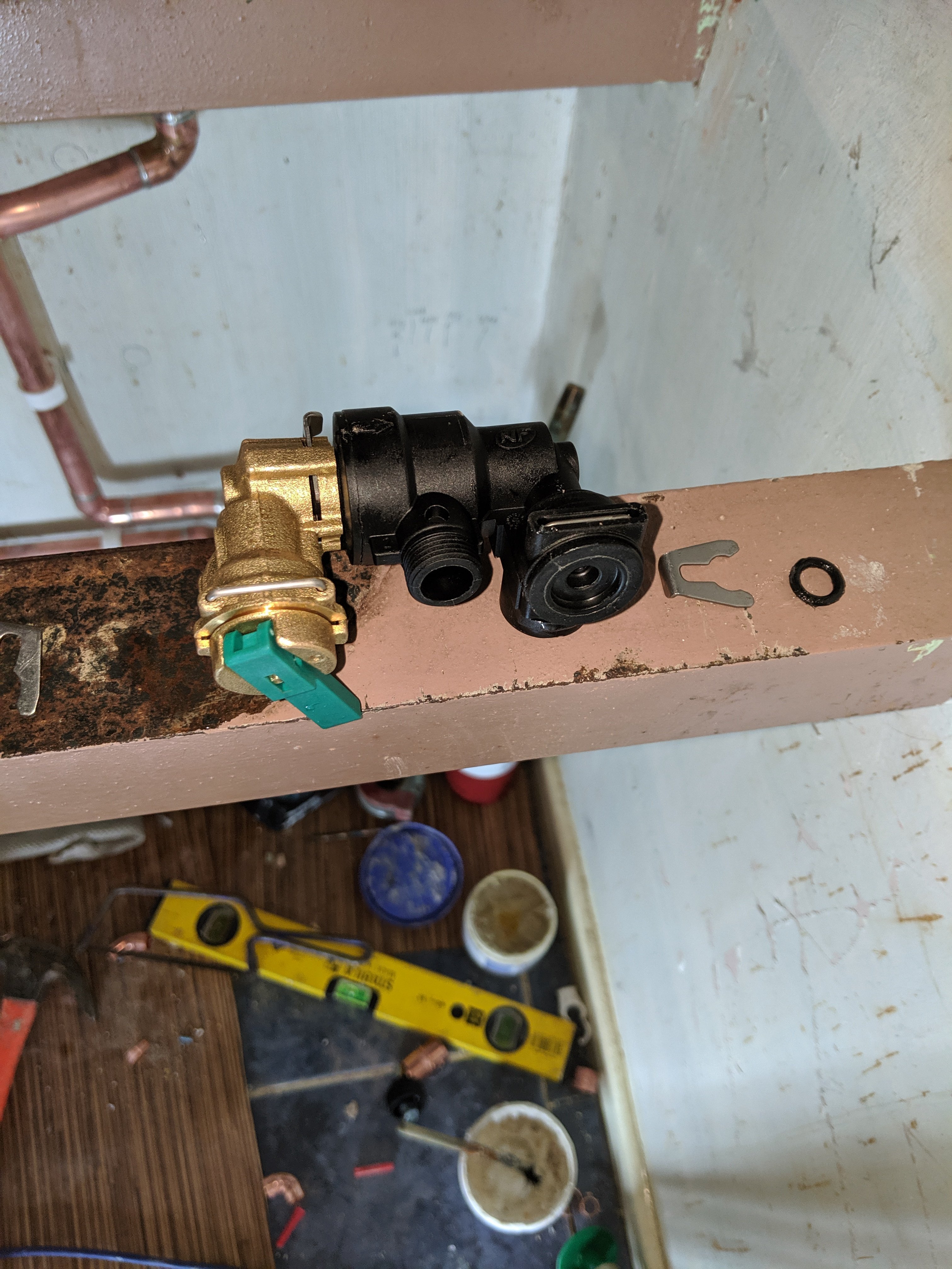

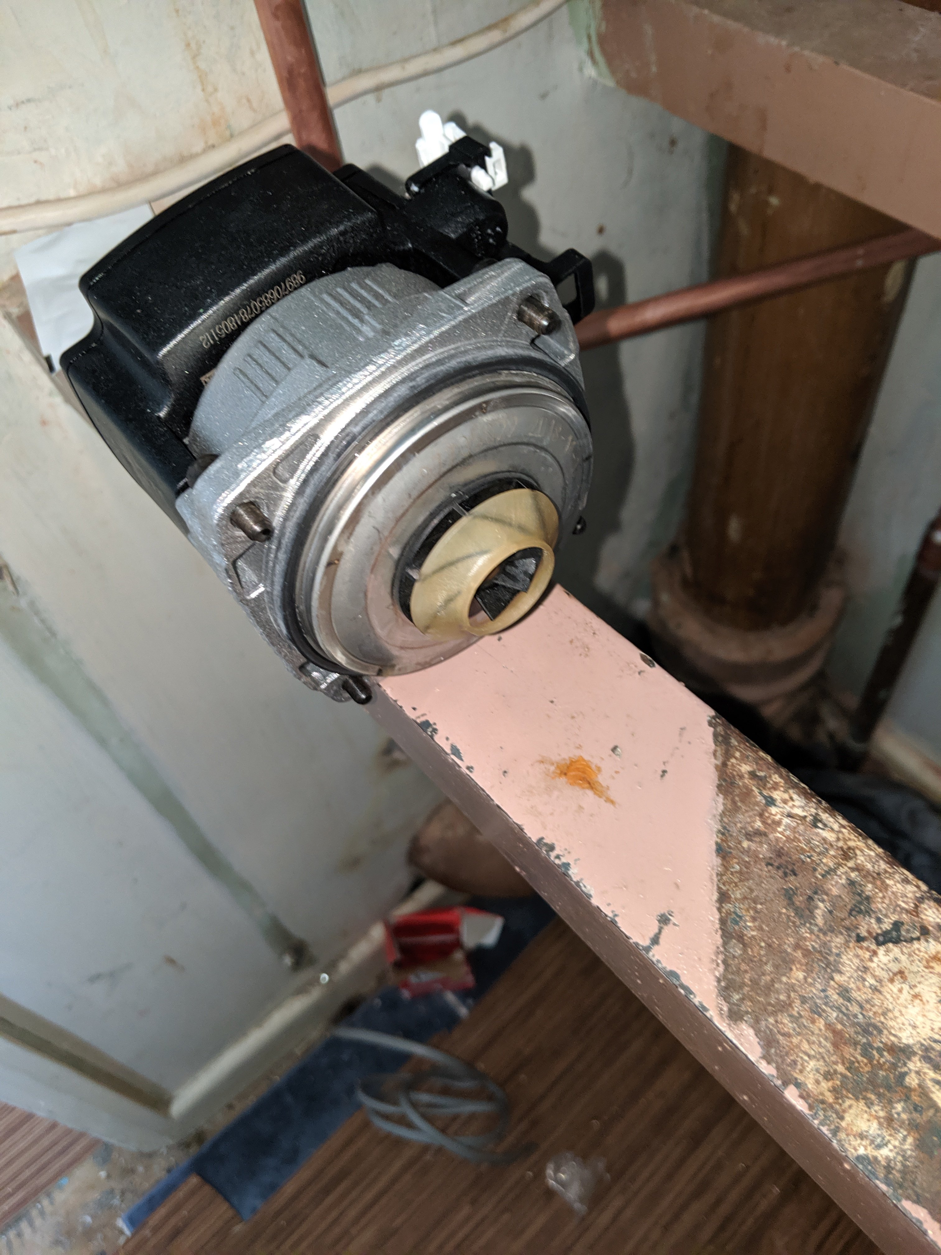

Finally got round to fitting one of these today Halstead ace out and Baxi 630 in , first impressions is not good, no jig ,new filling link is a faf to fit and s- ite design, commissioning it is a ball ache 7 minutes purge cycle not a lot of good when the fur kin pump is siezed grrr , so Soded off first job back after 2 weeks off had to leave it switched off until tomorrow , didn't have the patience to start pulling the pump out of a brand new boiler at 5. 30pm ,- really hope these dont perform like the intecs they do look similar inside this I why I left it so long . Sorry chaps rant over

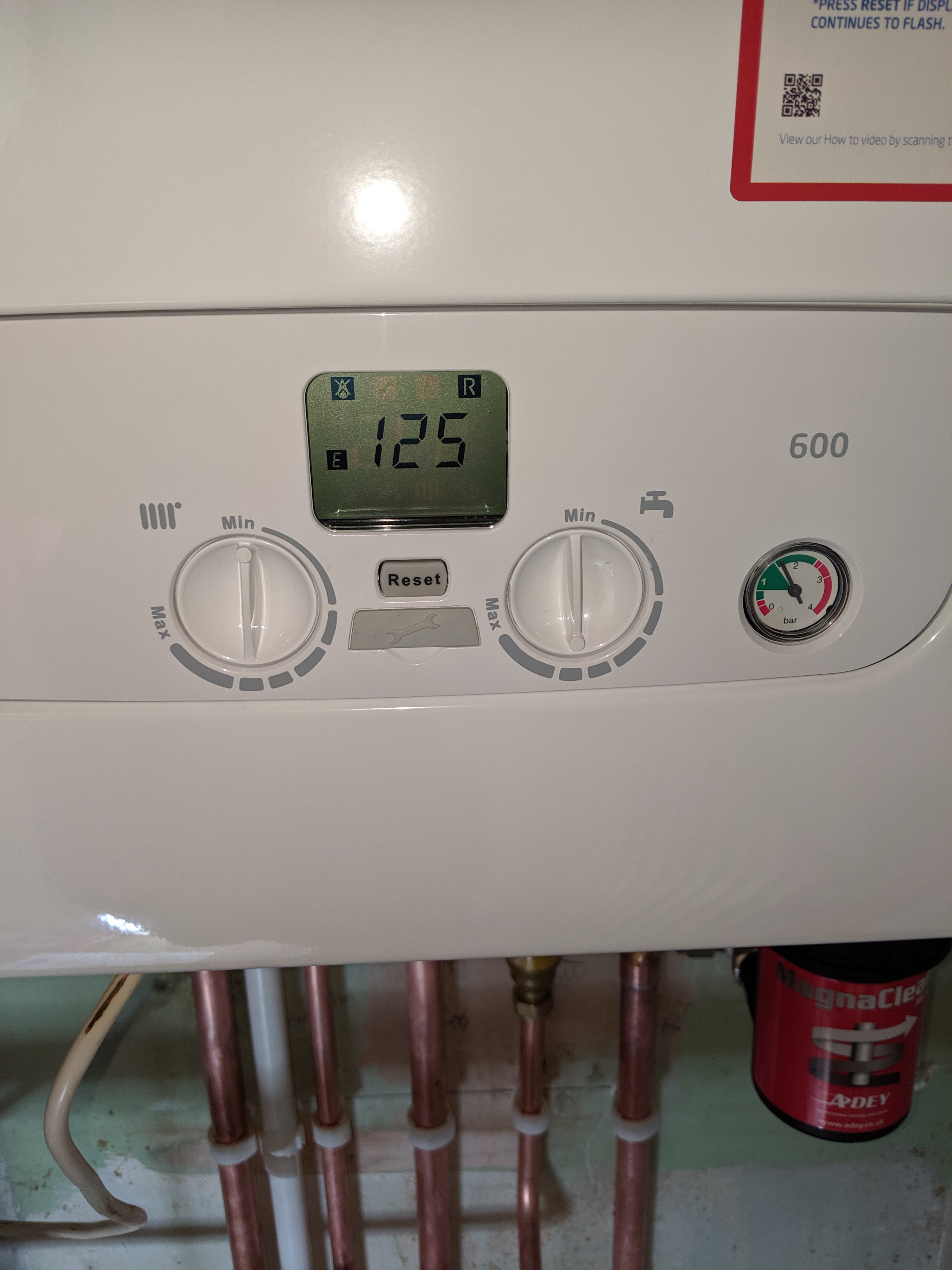

In a fashion Scott i was getting on with other stuff while it was doing it got the various codes needed then hey presto pump goosed I'm guessing it wouldn't reset as to much tempreture rise . Cheers kop

And the reset buttons don’t engage properly so you are pushing but nothing is happening

Yes mate just blinking that fault code wont reset my thinking is until pumps up and running it not sensing any flow through heat ex time will tell .

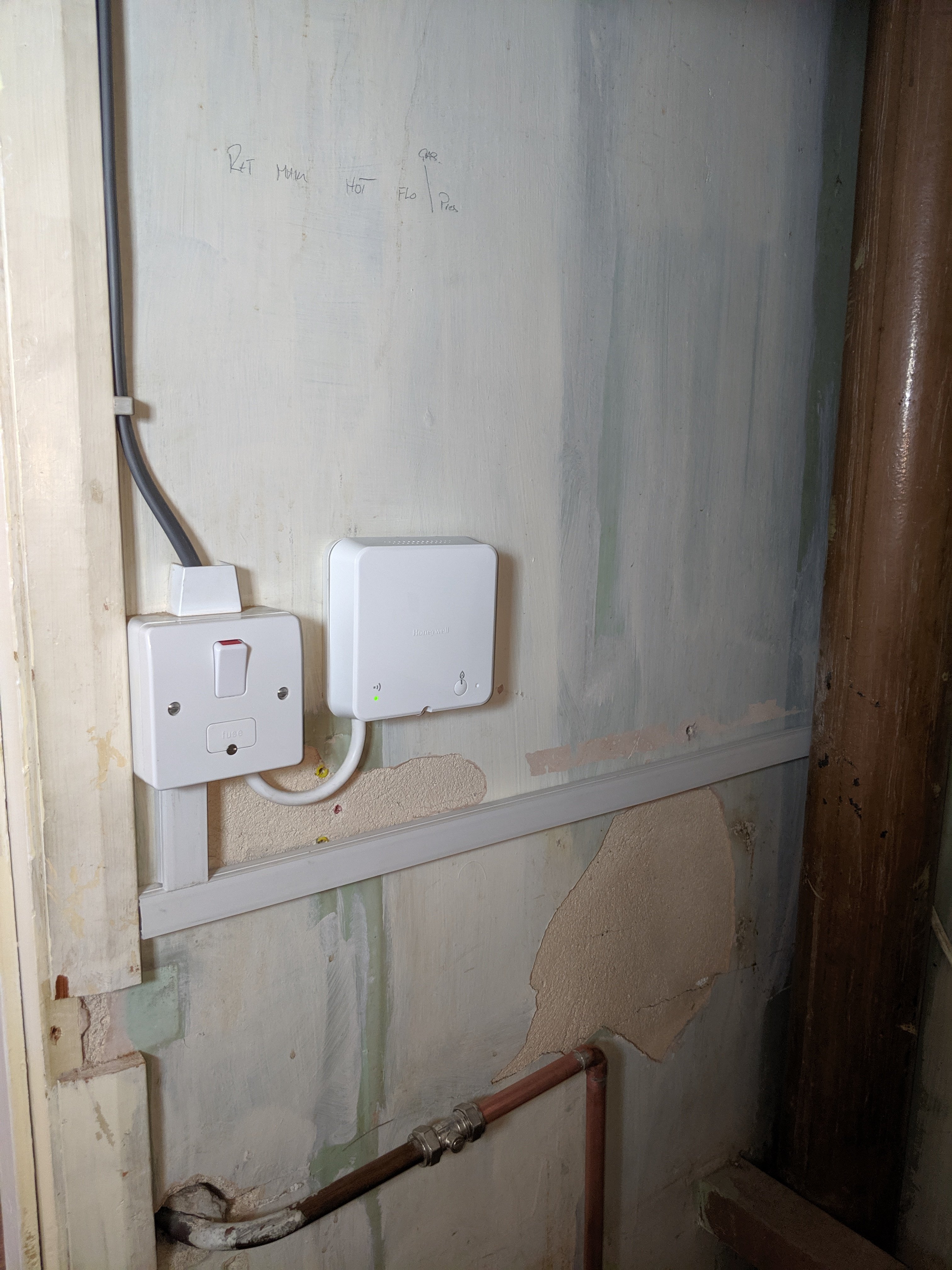

Worked quite well in the end bud easy to set up and quiet in operation connected a Honeywell T4 wireless programmable thermostat for boiler plus, for the money theres worse out there. Cheers kop

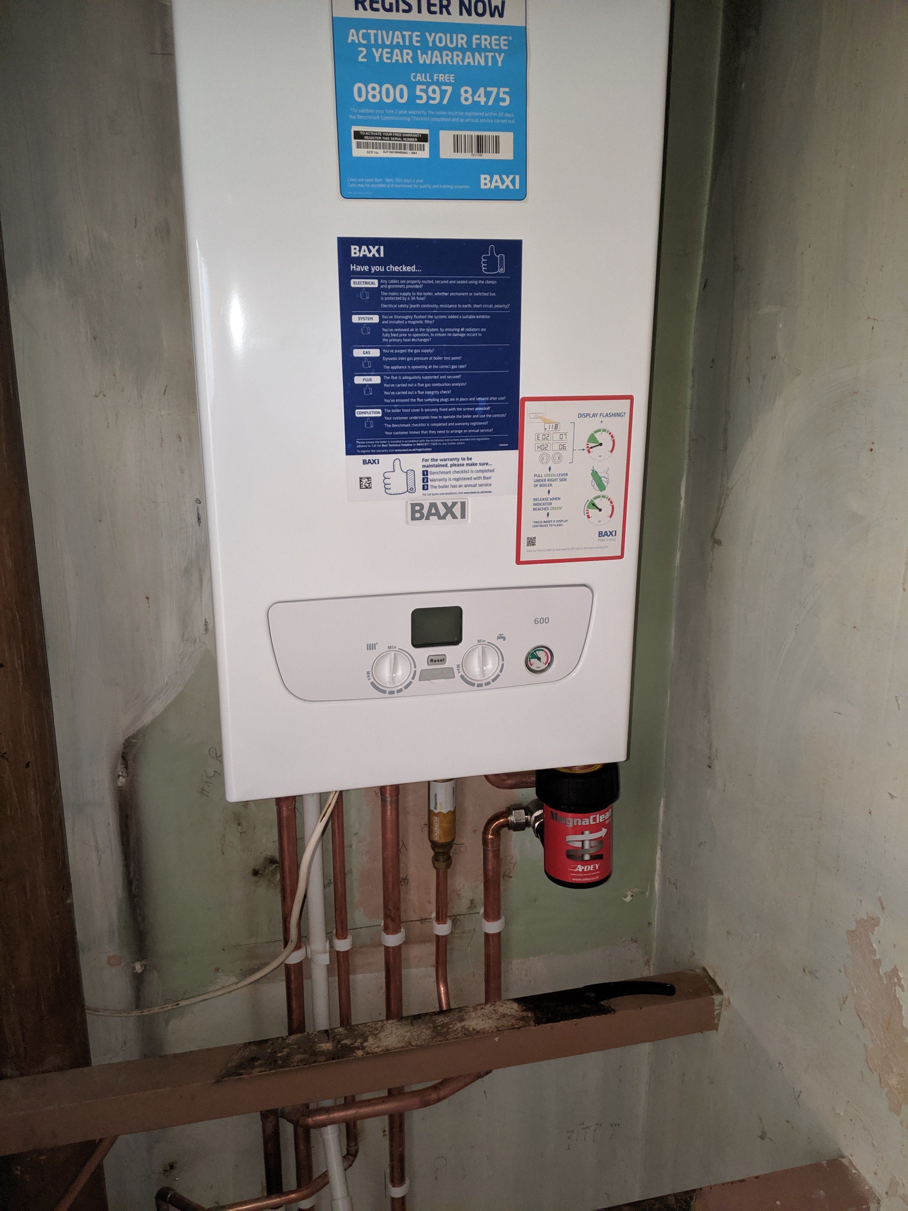

Another 600 fitted this week suited the design of the new kitchen going in shortly as it will be full height wall cupboards , I will tidy up the condense and prv when the kitchen is stripped no issues this time . Cheers kop

Neat job, is it a pre made kit for piping up the back?
No mate you get a add on plastic spaced clip bar but I didn't use it this time as had a vertical flue so no worries failing the flue with the pipework

I assumed pipes in talon clips would be too big for the void behind the boiler.
