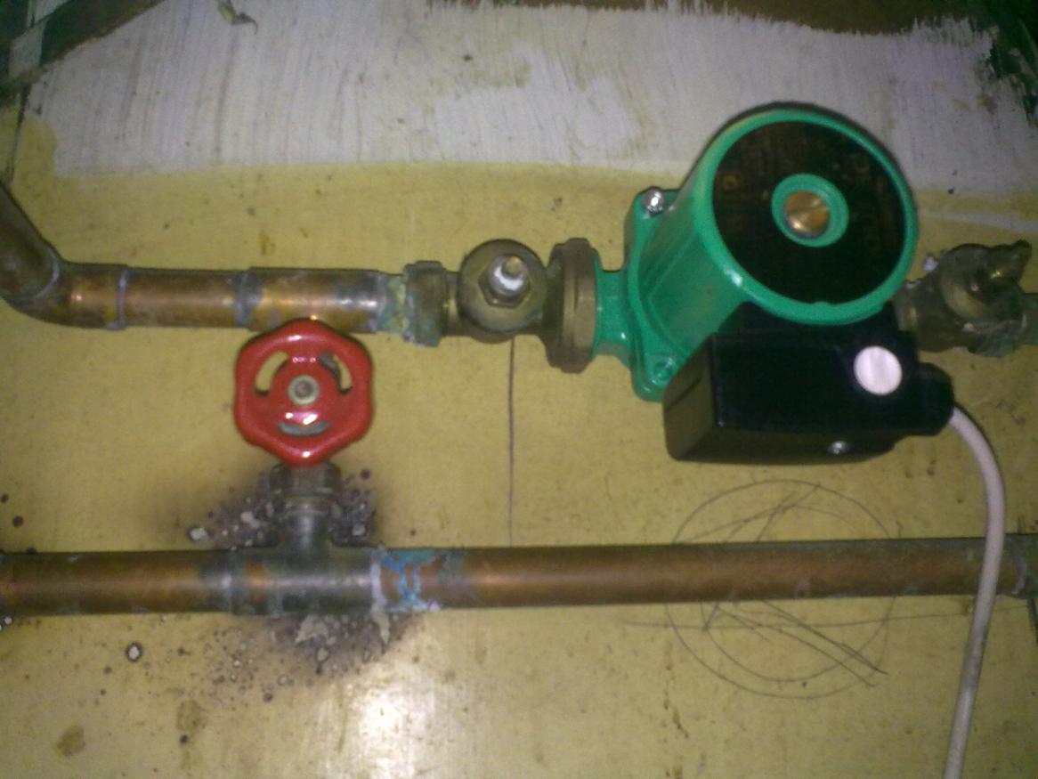

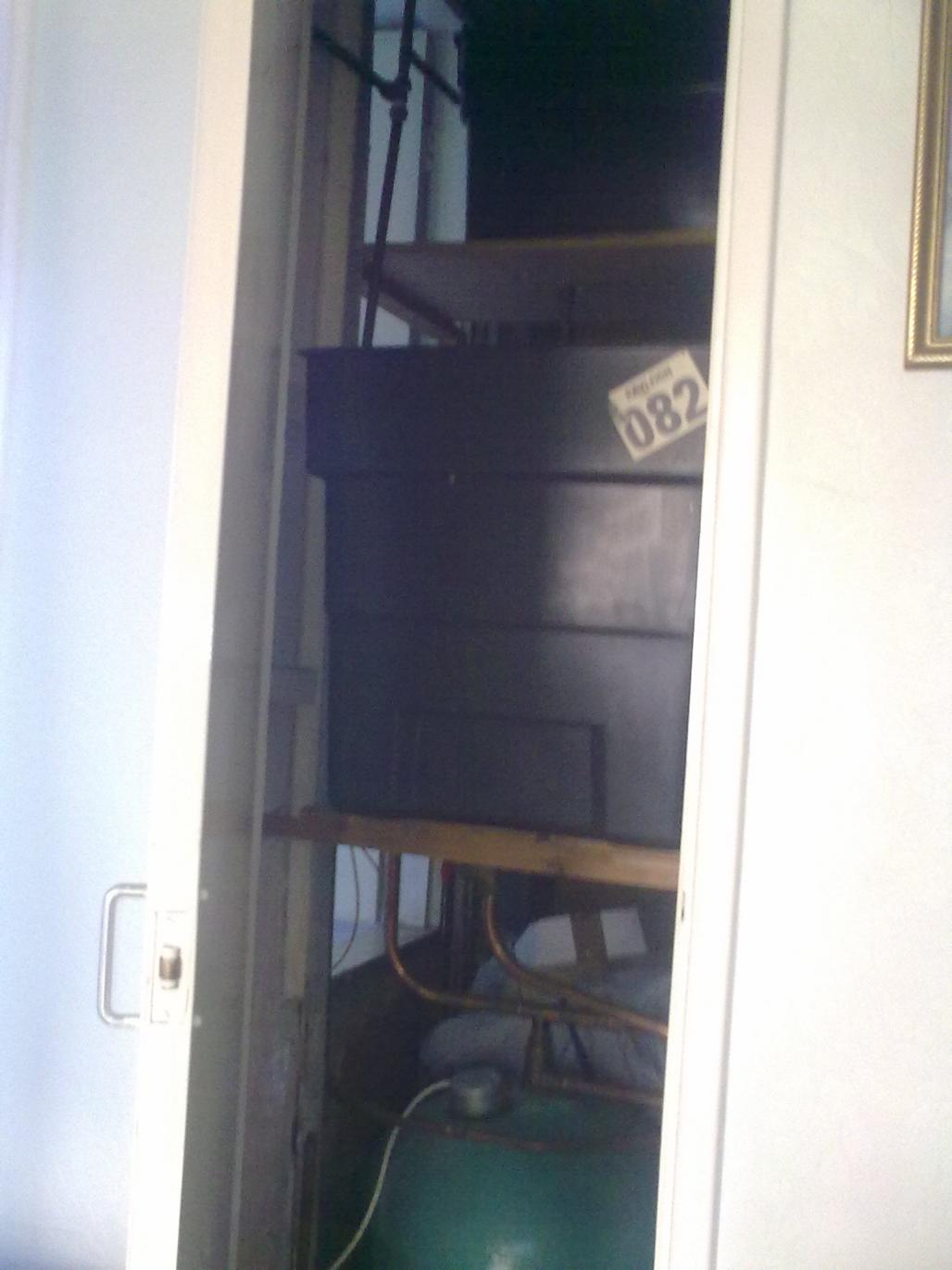

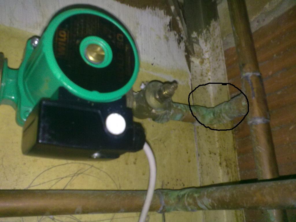

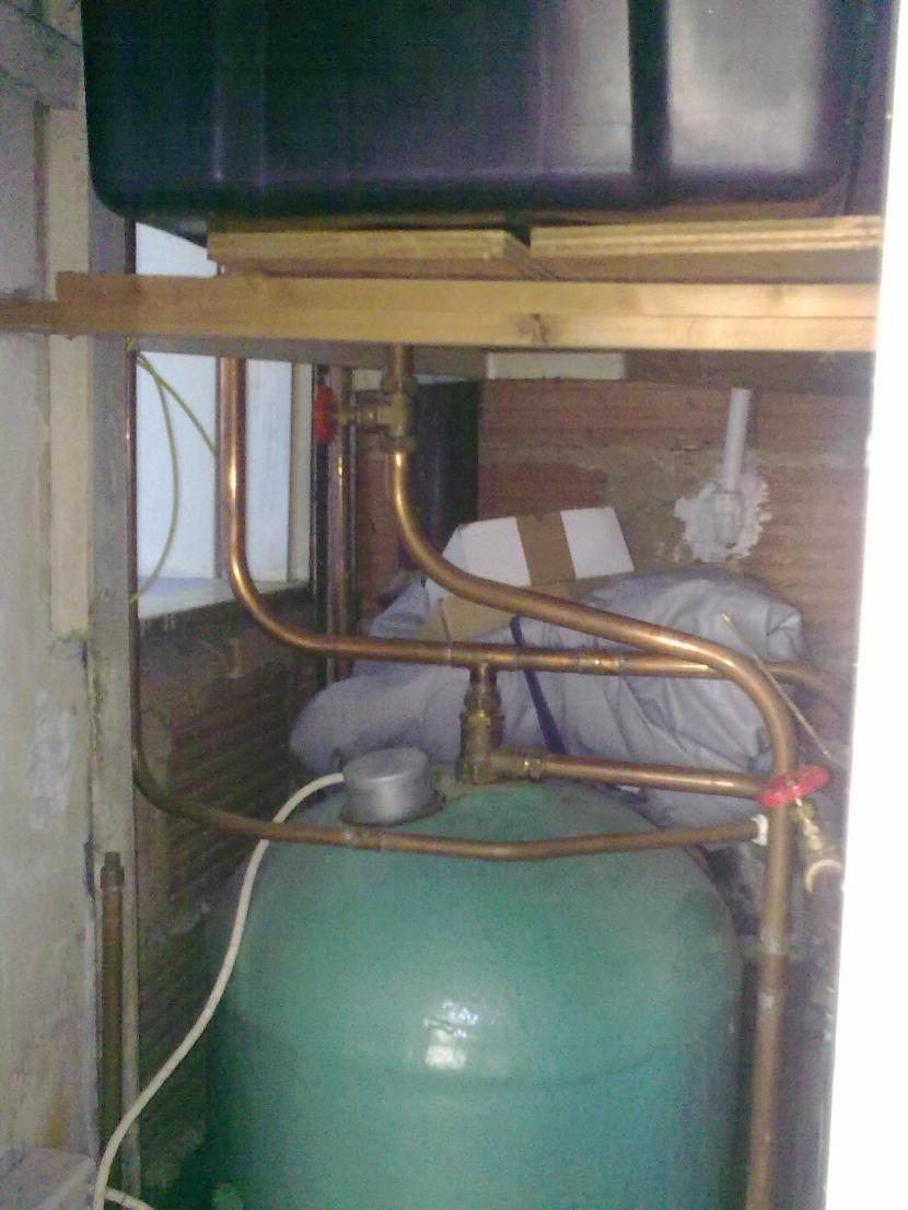

Dont forget to check for pump over
Hi Toddyplumb, checked foor pump over with CH only for 30 minutes, CH + DHW for 30 minutes and DHW only for 30 minutes last night, there is no water coming out of FE tank overhead pipe at the moment, so I suppose removing cold feed blockage solved pump over issues for now?
When the boiler is in DHW only mode, it makes some slushing noises every now and then and 1 radiator is also warming up. Would it be the 3 port diverter valve that needs checking/ cleaning?
I've bled the pump at its central screw and copper cylinder at the union to get rid of air. Is there any other place where this boiler can be bled? Its a Potterton profile 50e.
cut the vent pipe (on the vertical near the tank). Pour water down here along with fernox F3. Bleed the rads and continue filling / bleeding until rads are done. Rejoin the vent pipe using 22mm compression fitting. Run your system and get the cold feed cleaned out / replaced for the winter
thanks RoryD, that's a very nice way indeed to add system cleaner, mine is a Kilrock.
Regarding cleaning the cold feed, I think its clean after I took it apart and cleaned all the pipes n replaced fittings. All the rads are now filling rapidly from the FE tank and clean water is flowing out of rads now after a few drains.
Its working OK, but when the boiler is in DHW only mode, it makes splashing noises, akthough water is getting warm as before. The CH is not coming on now when the setting is only for DHW.
