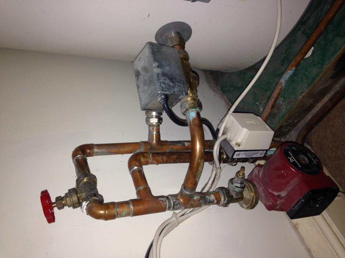

- 2 x 2 Way valves (im guessing 1 for HW and 1 for CH) I think one is a honeywell and the other a Drayton (one is silver metal the other is plastic) - see photo

Is that red tap a bypass? Is it supposed to be closed? It's currently open..
