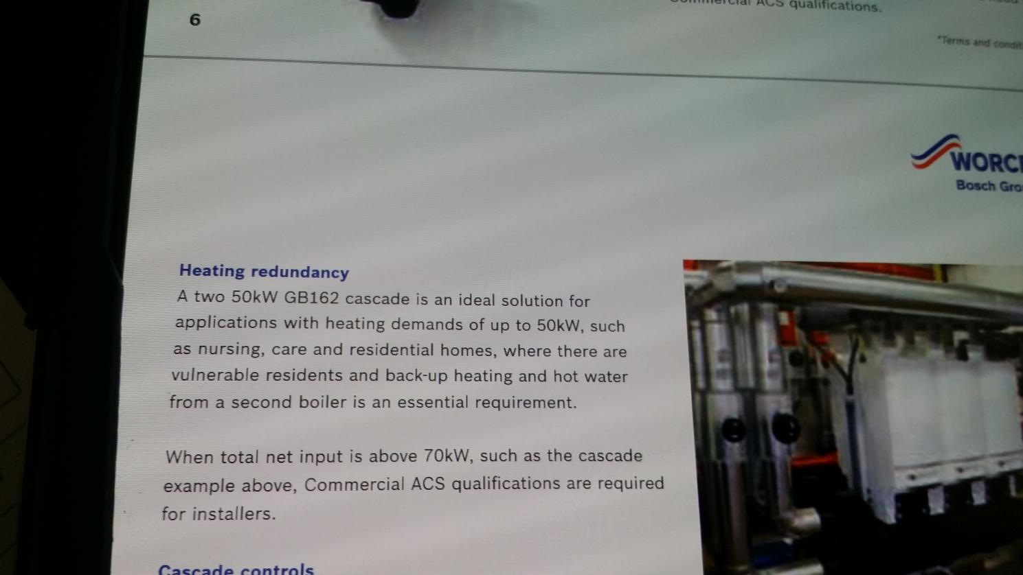

I'll be getting a commercial guy to do gas side of boiler, nothing stopping me doing hydraulic side. I will post the conversation between me and technical when I get the chance. They have confirmed.it will work on a domestic S Plan, just need to find large 2 port valves lol

This is correct. There is so much confusion surrounding commercial gas it's untrue. I had a similar question and the following facts apply.
Firstly as long as the boiler is under 70kw ie not a commercial boiler then you can install it, note worcester product you are looking at is a domestic boiler but a large one and is based on commercial design so that's where people can get some confusion. I'm pretty sure also that worcester insist on putting anything above a certain size (I think it's 40kw but don't quote me on it) into a low loss header so as the boiler can keep up with demand.
The next and most crucial part. The definition of commercial gas work is NOT defined by the property type. I see sooooo many people assume this.
It is deemed by the supply size your working on at this property. If the volume of gas installation pipework exceeds 0.35m3 then you must hold commercial acs tickets...
So what I would say to you is when you survey the work you look at the present installation of gas pipework and work out volume. Is it correctly sized for new appliance? If not what size will it have to be and what will the new volume be. If it's getting pretty close to 0.35m3 I wouldn't take the chance.
I got a lot of conflicting info on this but got there in the end. It is definitely down to gas pipework volume and not the property.

Not only boilers - ALL gas appliances totalled up. If you have a 65KW boiler, and a 7KW hob, you're outside domestic scope.
