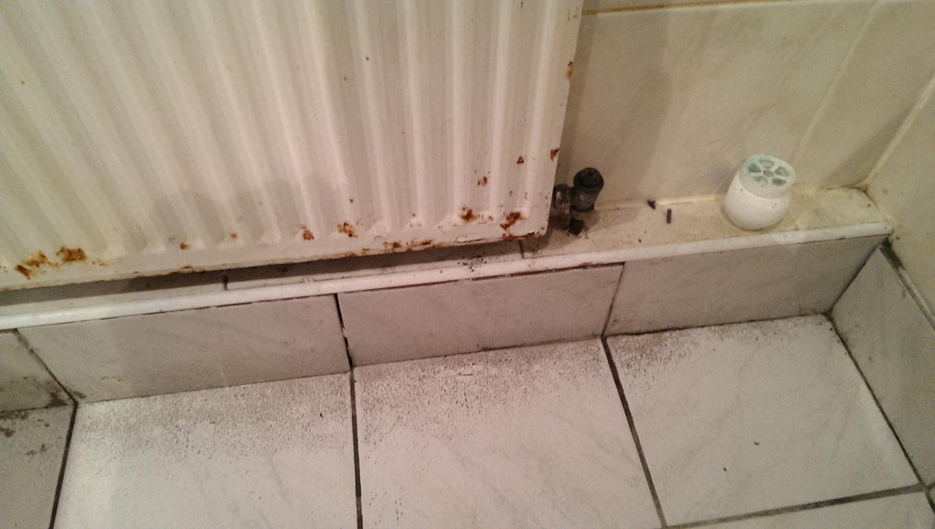

I found this radiator to be the cause of a similar situation
That's understandable. All the rads look in really good condition and there's no sign of water leaking in the house. Also the pressure drop was when the boiler was fully isolated for 8 hours so it's definitely in the boiler. I know the isolation valves worked fully as when I opened them the pressure actually went back up to 1.85 bars.
