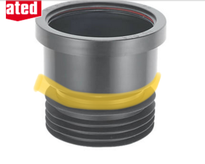

The clay wall pipe is a different size. Having trouble finding out what that is, so i can see if their is a PVC alternative that will go to 110mm
Clay is larger diameter you need an adapter similar to this, that will go inside the clay.
You may have to cut the upper section of the clay connector to allow the adapter to pass through and fit insde the clay still in the ground. Pvc 110mm will then fit into the adapter from roughly the same height as the clay starts now.
Does that go all the way in to the top lip?
No just to the fins,

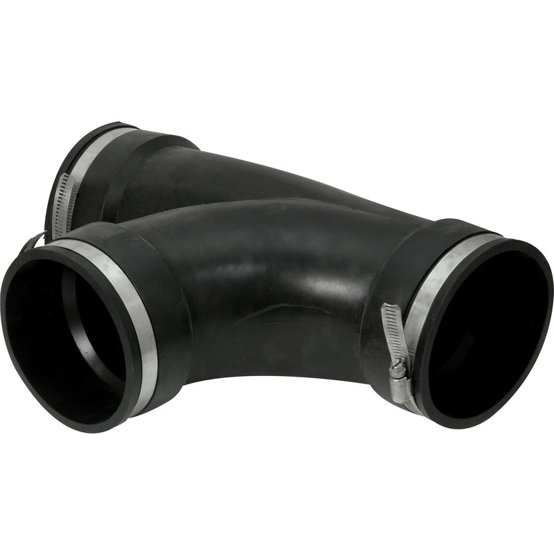

You might be able to get a manifold in there under the branch, to give the additional low level shower connection at floor level.
