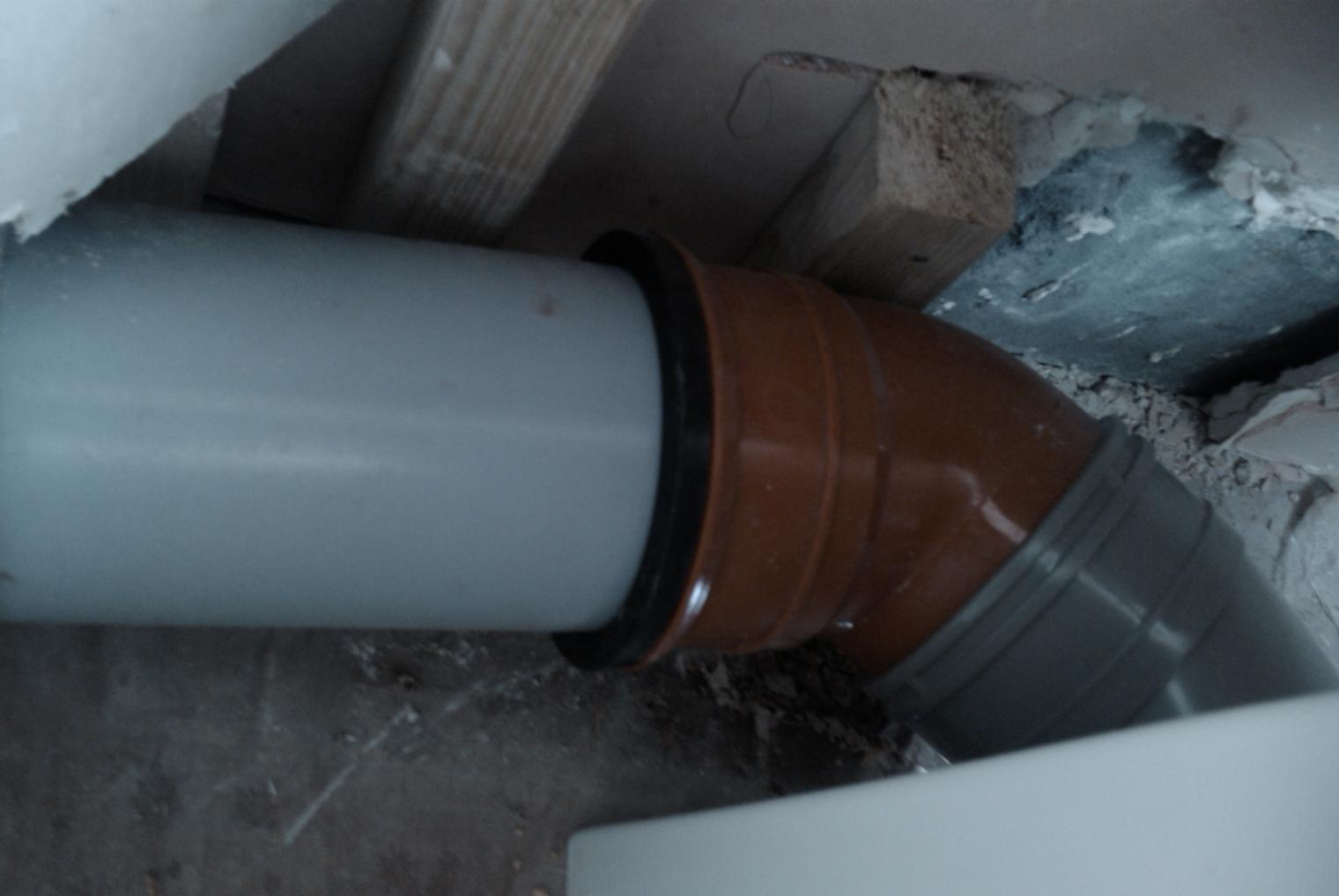

I have just had my soil stack altered to accomodate a corner toilet without a flexi. I was very pleased with the finished result: the toilet flushes really well, no up hill pipe, and no worries about flexi in the wall falling to bits in 5 years time. However, 3 plumbers have been round to quote for the bathroom and pointed out that the bend is brown and pushfit at one end and apparently solvent welded at the other end to a grey bend. Could this be a solvent weld compatible pushfit (not sure if there is such a thing)? Could this lead to problems later?

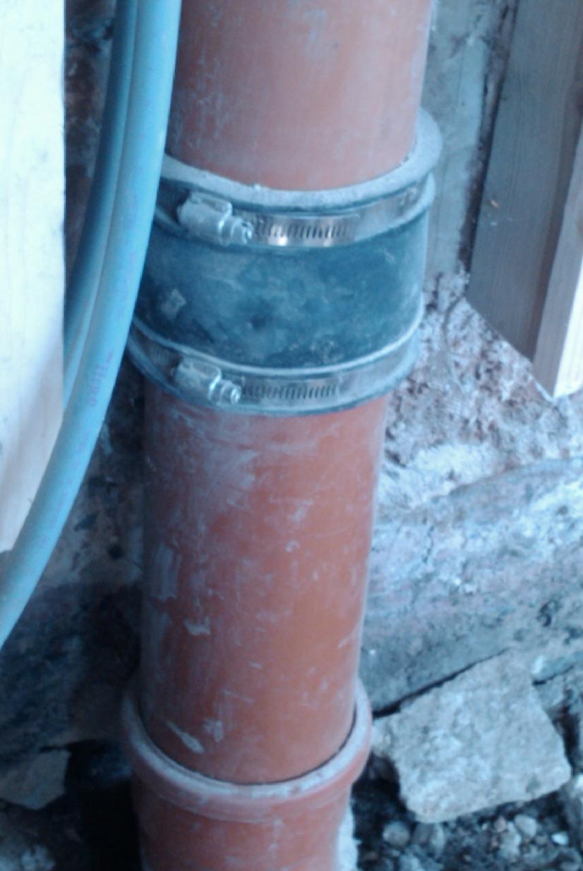

My 2nd question relates to the use of jubilee clips instead of proper connectors. Are these more or less reliable than the proper connectors? I have 2 fitted: 1 near top and 1 at the bottom of the soil stack. These will soon be buried in the wall, so I need the most permanent solution possible. Any advise please...?

answer to 1 it is not normaly acceptible to use brown 110mm fittings above ground as they do not have protection against UV light, If its going to be boxed in and no light gets to it then it will probably be OK, also there is no problem gluing grey and brown fittings together as they use the same glue.
answer to question 2 is I personally am not a fan of these type of fittings but that is just an opinion I seem them as just a temporary fix until a proper job can be done I would have used a slip collar and it would have been cheaper
Thanks for that unguided1. It will be boxed in with 12mm ply and tiled over with some kind of access panel.
What does UV do the brown pipes then?
Over the course of a number of years brown pipes will become brittle and fail as they have no protection from Ultra Violet part of the light spectrum
I dont mind Fernco rubber couplers, there has been one fitted outside at my mums for the last 27+years, change it if it really bothers you.
