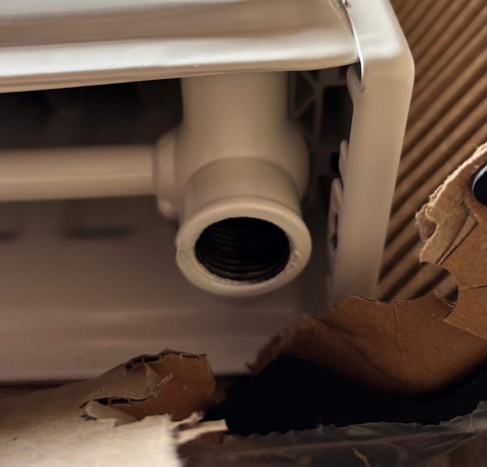

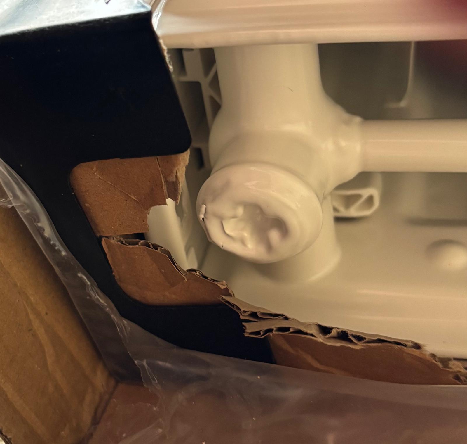

Just taken delivery of a new Stelrad vertical radiator
Can somebody tell me how to remove this, to fit a trv
The other side does not have one but there are also two in the middle ( i'm assuming they need to come out also to be replaced by a proper blanking plug)

I whacked it with a hammer to break the paint and used the clawhammer end as a screwdriver. its brutal it worked. Paint edges needs cleaning up though
