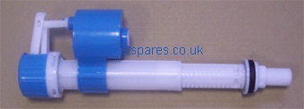

Cheap Chinese rubbish I think - usually when you see that colour on the flush valve.
I have seen that same set before but not sure what it is.
I think Shires started using similar.
Definitely the same flush valve used by bath store. Give them a ring and enjoy there technical department....
I changed one of these washers last week , i had a nightmare getting the washer and not a common one as it has loads of little dimples on it, il try post a pic ,
[DLMURL]http://toiletspares.co.uk/images/A207_diaphragm.gif[/DLMURL]
The washer i ended up using was very similar this, but it isnt this one,,, i actually took the old washer out and took a pic , re=assembled and scowered the internet,, the photo u posted theres hardly any of them online because i was also trying to find the flusher and they really are not as common as others
Thx chaps
Googled Aimas, to see if they had a site so i could see a better pic, turns out they are the same company as Wirquin. Tried Aimas A207 first nothing came up, so then tried Wirquin A207 and found it turns out its a LAB A207.
LAB A207 Adjustable Filling Valve
They have a washer for it, bit of a result!
