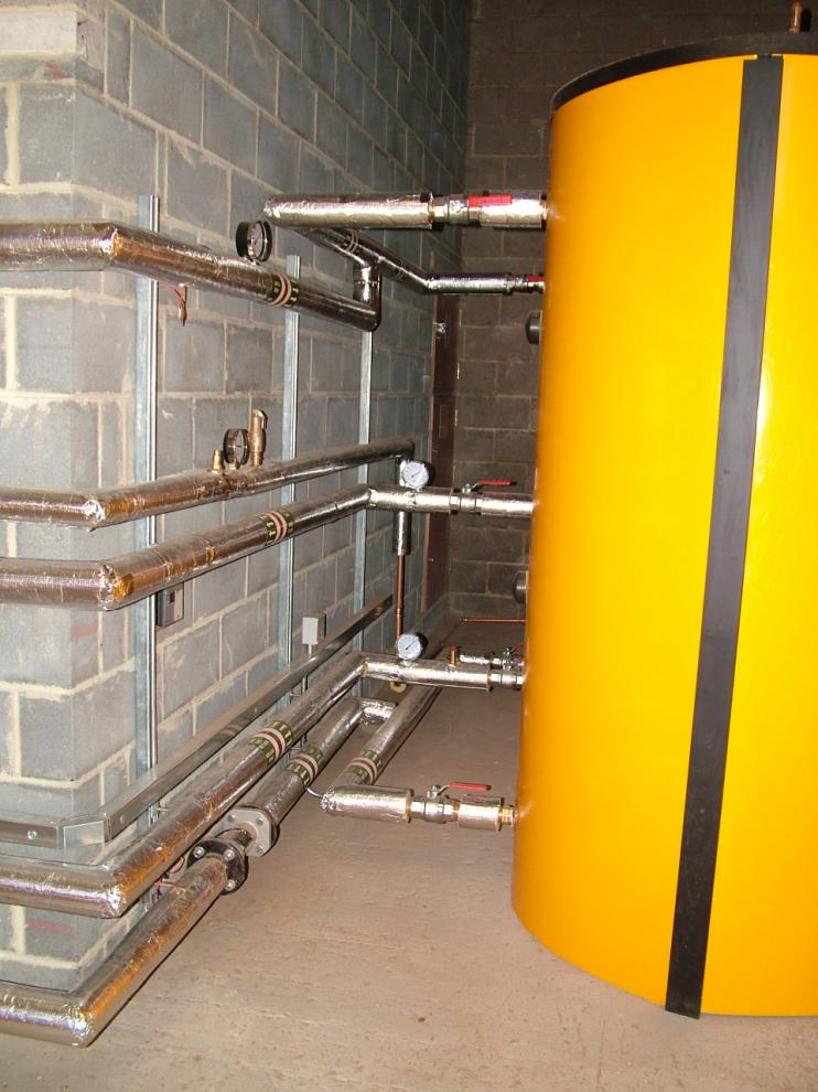

DSCF6096.jpgDSCF6106.jpgDSCF6112.jpgDSCF6754.jpgDSCF6750.jpgDSCF6757.jpga couple of pics from a recent job we have just finished. 90kw Froling boiler out and a 200kw ETA in. Previous system was totally undersized, if all the properties on the district heating system called at the same time, then only half of them got heat, The boiler was constantly running just to try and keep up, even in the summer when there was no demand for heating, and 4000litres of buffer stood cold!!!.
We replaced the boiler, rejigged the fuel store to allow us to move the buffers (new ones fitted) and then upgraded the pump set.

How much have you come on in the past while Missplumb.
Good to see you are enjoying yourself. Neat work btw :smile:

I agree with tamz you work is looking excellent
tbh, it wasnt part of our contract to remove the old gear from site and we wouldnt be happy fitting a new boiler and connecting it to existing buffers etc, if they failed then it wouldnt look good for us even though it wasnt our fault.
it was fitted by Econergy (british Gas). it was done about 2008 so before the rhi was available. everything was undersized, boiler, pumps, expansion vessels .
