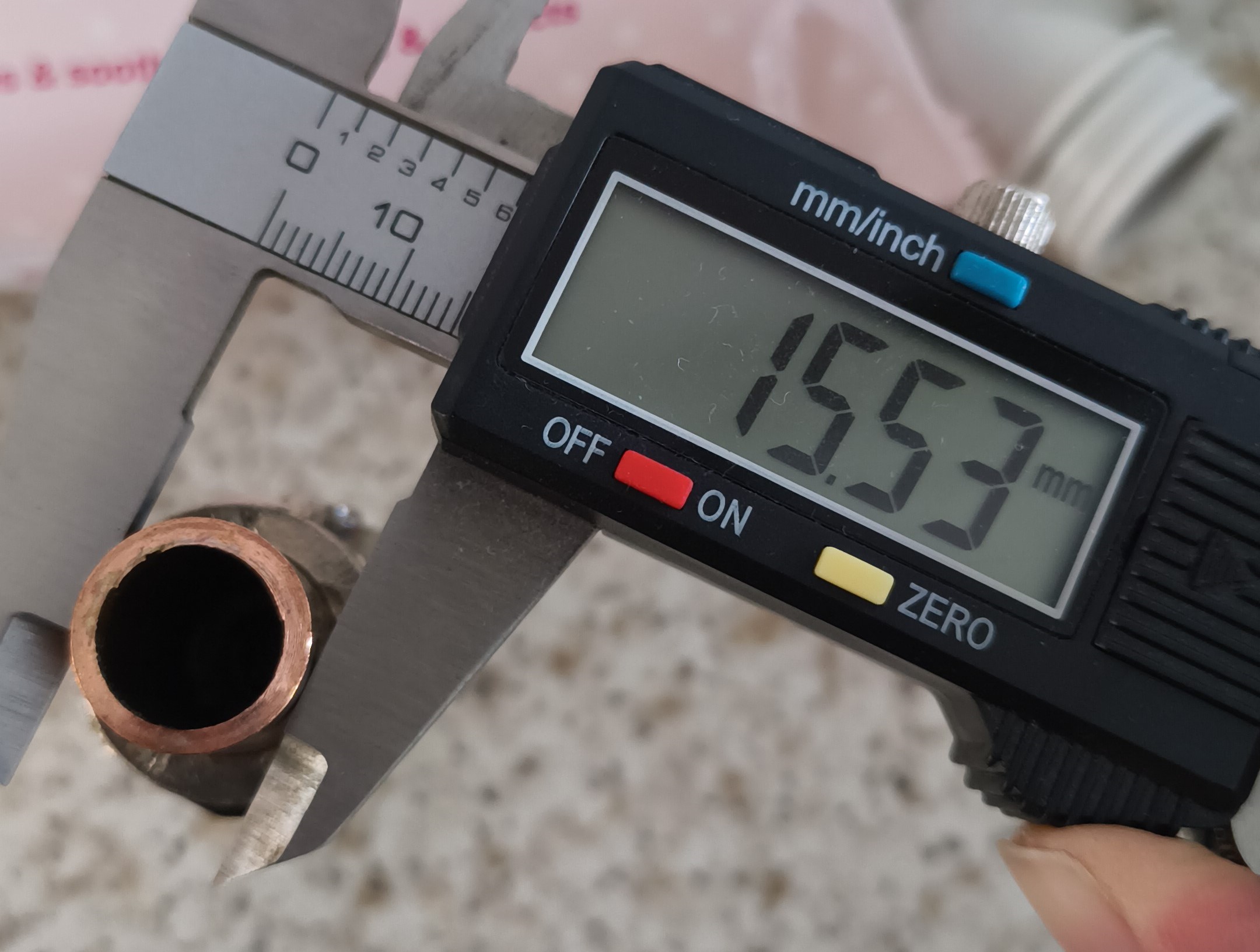

I don't think it's either of those which is why I think it's been such a problem. It's definitely around 15.5mm, not as big as 15.88 but bigger than 15.14 to not fit it any 1/2" adapters couplings. It's also quite consistently that size and doesn't appear to be oval so not just freeze-swelled as other places suggested. My research didn't find much apart from those references to "Rhodesian" or "council" copper on the Internet. The guys in my local plumbing counter didn't know what to suggest, and a plumber in the shop joining in seemed to think it was regular 1/2 and it would just be a bit snug in a 15mm. Wish he was right!

Caliper measuring pipe for those interested. Walls look a bit thicker than they really are as it was cut with a pipe slice.

As it is in a loft it may have been expanded a bit by freezing. Measure the pipe a bit further back with your vernier gauge. You may find it will be OK.
Old 1/2" copper was only slightly larger than 15mm. Conex fittings always had enough play for them to fit, some of the italian brassware was much tighter.
I've not had a chance to get back up yet but I will have another check when I do. I did measure it a bit further back and it seemed quite consistent but I'll measure as close to the floor as I can and see if it's any different.
