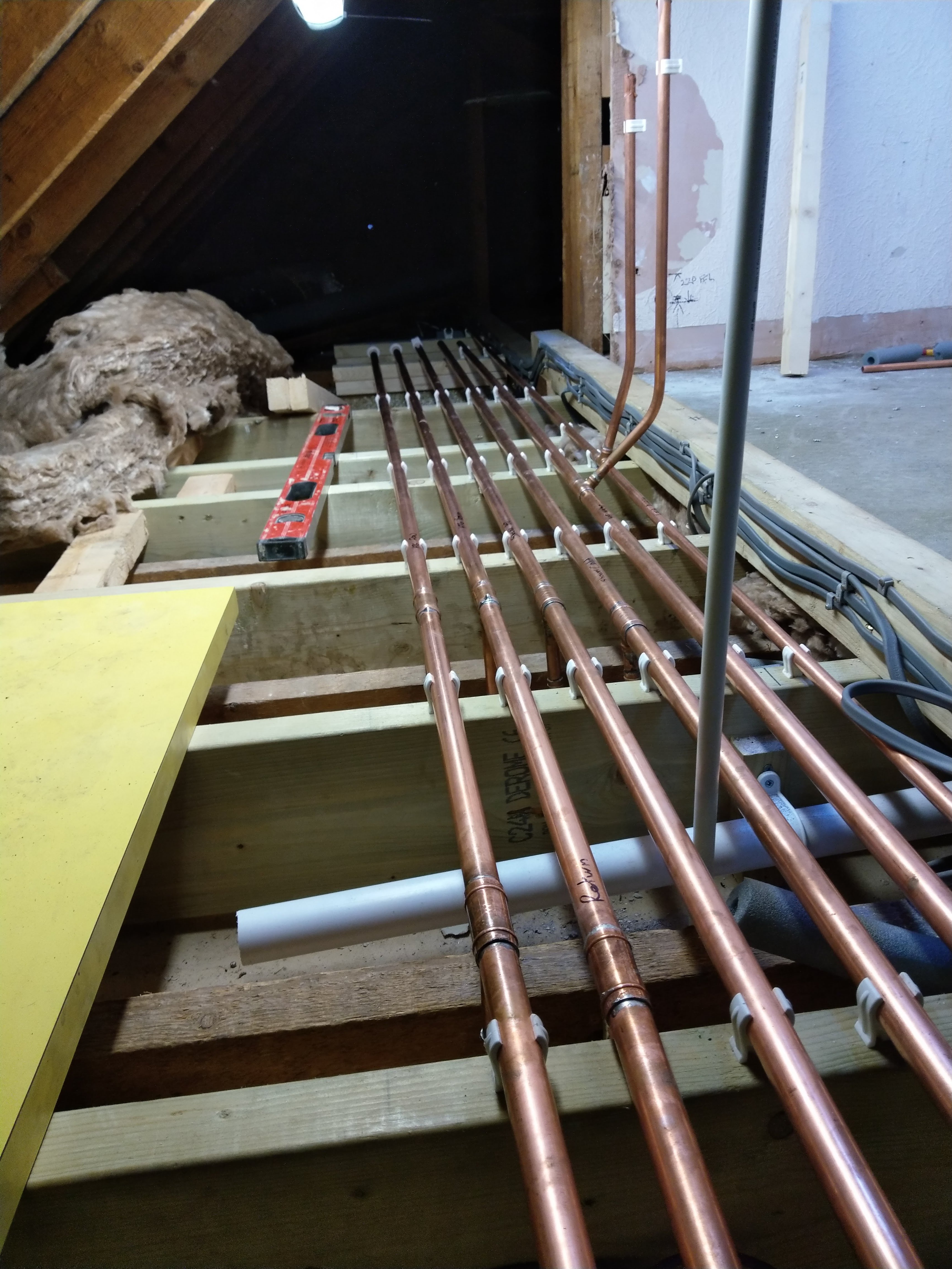

I've done this upstairs in the eaves for the bedrooms so don't mind soldering joints but I don't want any under a floor I can't get up without destroying it!
