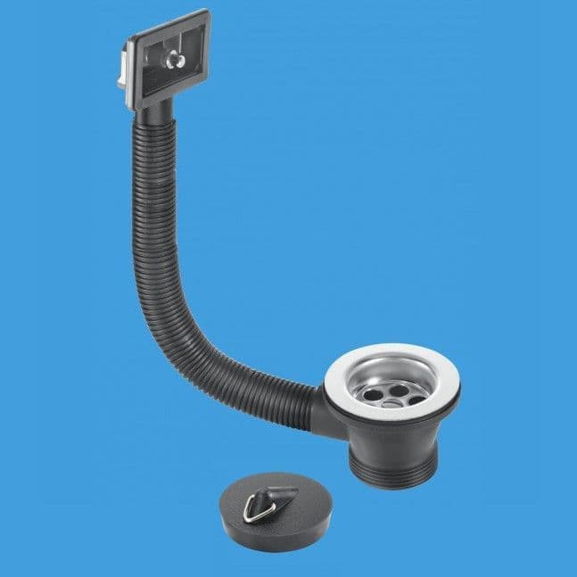

You can get rid of one of those extensions 100% possibly both by lifting the trap up if the washing machine spigot piece is too long cut it down as you have a removable nut on that one correct ?
Also what’s the kitchen sink plug top / waste connection as that looks like a long one eg could replace with the below etc

You can also change the sink part so this is also reduced
Just been to toolstation, their sink things are all the same depth so can’t raise the trap, gonna have to get a plumber in to shorten the standpipe, I daren’t mess around with welded pipes 😬
Is this shorter than yours ?
51mm from the bottom of the sink to the end of the threads
