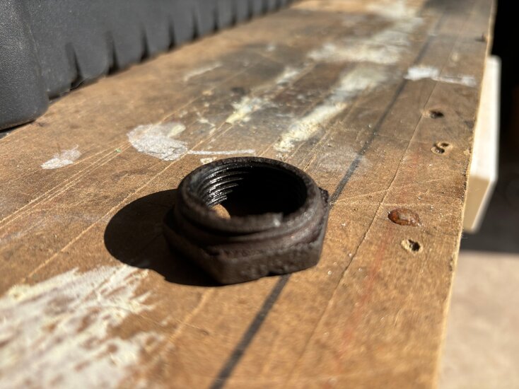

Does anybody know where I could find this fitting which is a reducer? photos included
View the thread, titled "Does anybody know where I could find this fitting which is a reducer? photos included" which is posted in Gas Engineers Forum on UK Plumbers Forums.
I think it is a gas fitting, although it is used in an old LNER station lamp post.

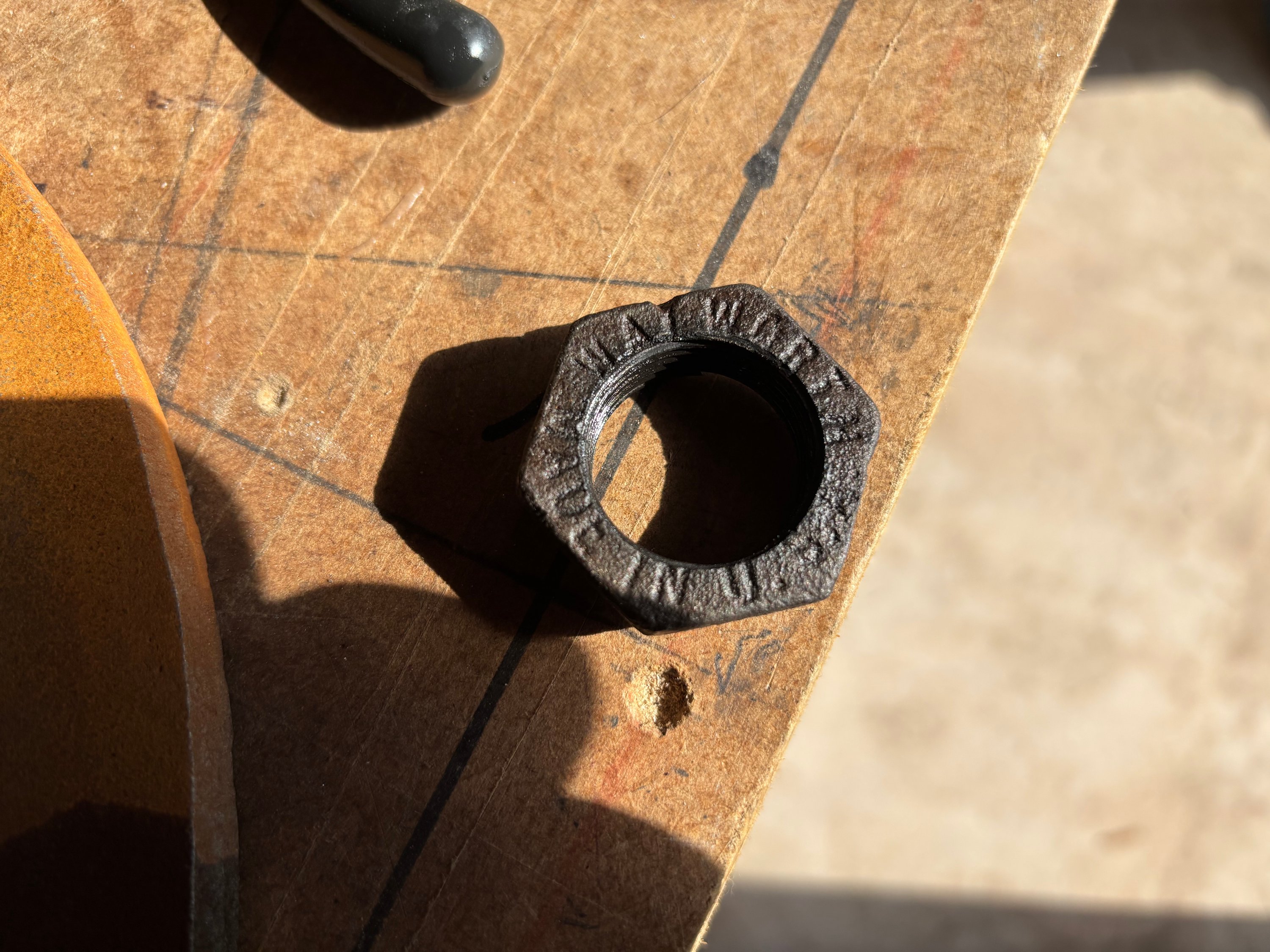

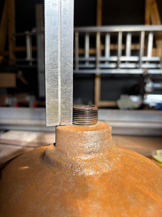

The reducer female part measures 15/16" the male part measures 1 5/16" approximately.
It is stamped WALWORTH MADE IN THE USA

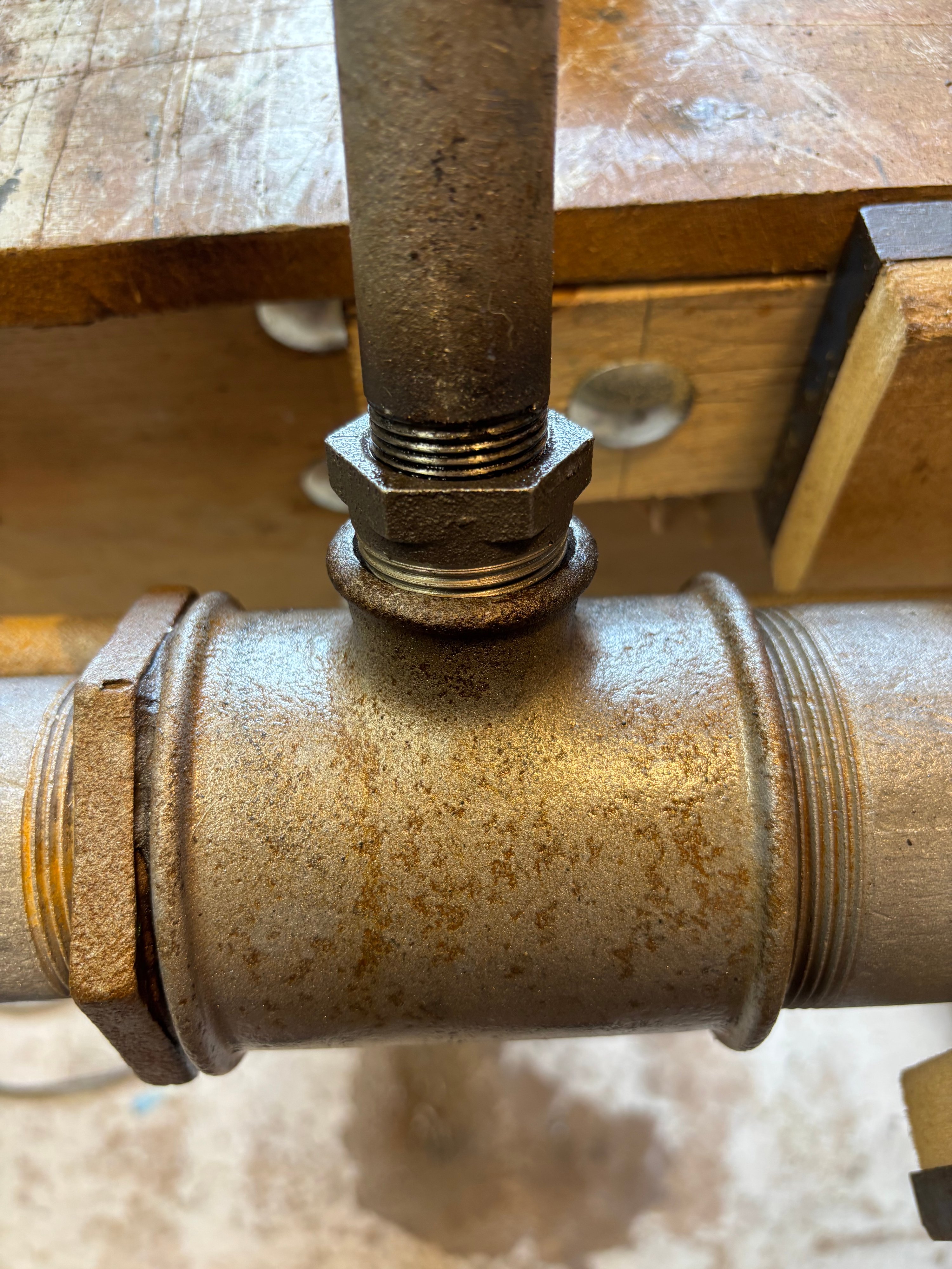

It also fits the lamp shade but is actually from the post to support a braced cantilever piece of conduit.

Hard to say without seeing a tape on it but looks bsp/npt so might be in look with a 1”x3/4 reducing bush
Thanks Shaun
I obtained one and it seems compatible and fine for my purposes which isn't plumbing but restoration.
It's a tapered thread so not sure how much to tighten safely
