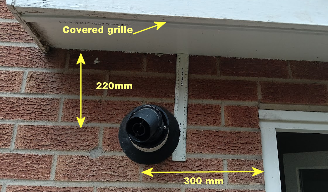

I had a new boiler, Worcester Bosch Greenstar 8000 Life 35kW, fitted in Oct 2021. In 2023 I had a service, but the engineer was getting bad co readings, and declared the boiler unsafe, telling me to contact Worcester Bosch under warranty. That engineer arrived, and said the service engineer did not properly understand the adjustments, and that it was now working perfectly. However he did point out that the flue was incorrectly sited about 230mm under the eave, which had a ventilation grille. He suggested the proper thing would be to get a flu extension fitted, but that I could just cover up the grille, which I did. He also repositioned my CO detector, which I had on a worktop, up nearer the ceiling.
Since then the CO detectors (I have two) have gone off several times, sometimes in the middle of the night! The reading is always very low (50-80ppm), and I am sure that the cause is CO entering through the loose fitting door. I adjusted the latch, and added a draught strip, and since then have had no alarms.
However, with the warm weather, we sometimes leave the door open, and if the boiler is heating water, the fumes can be blown in to trigger the alarms. They are very loud, and upset both us and the neighbours!
Is this installation compliant with the regs in October 2021? If not, do I have a case to go back to the installer (a big national) and ask that they remedy this?
