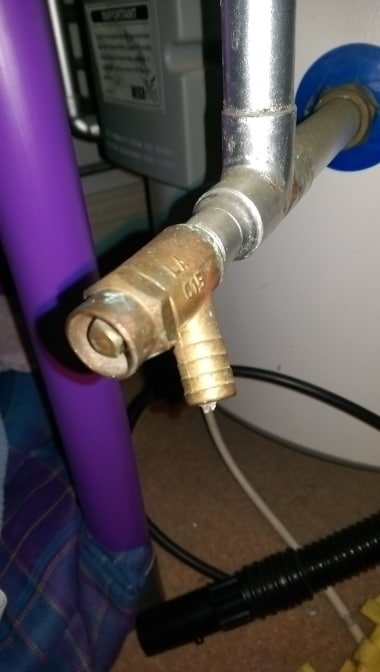

I am changing a couple of TRV's on this system. The drain off on the unvented cylinder is weeping.
Would you just tighten it up and tell them to let you know if it still weeps or once pressure is let off/vacuum achieved to change TRV's could you take out the works and change them/the washer at the same time?
I don't know how these cylinders work so wanted to check that would be a good time to do it.
Also which works/washer would I need? None of these I've linked to look quite like it
https://www.NoLinkingToThis/c/heati...31690&page_size=20&page_start=0&sort_by=price

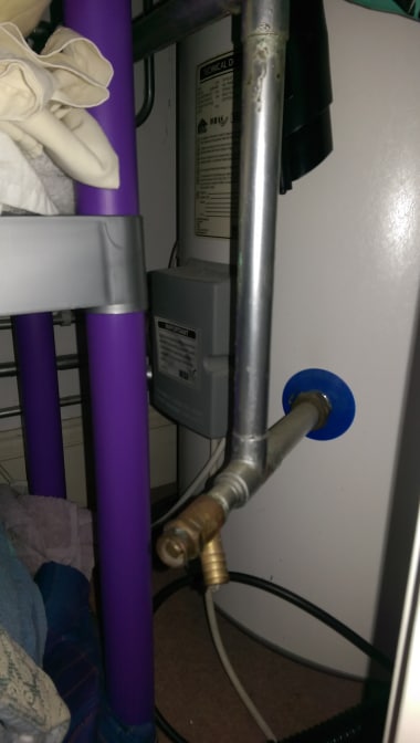

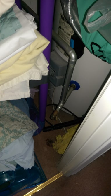

So don't know is the honest answer there. Here is a photo with bit more persepctive in case that helps?
If that's a Megaflow it appears you are looking at the cold feed to the cylinder there, not the heating side (Primary coil). That's not going to help you change the TRVs as that is not connected to the heating system.
As for how to fix the weeping drain off, it's likely to be a 3/8 inch washer you need. The innards screw all the way out (like you would do for soldering to avoid damaging the washer with heat) and the old washer just pulls off a little stem and a new one pushes on.
It's possible the old washer will stick inside the body of the drainoff so you might need to fish it out with a small screwdriver.
As for being G3 registered, you are not actually working on any of the safety devices or pipework but I will defer to others whether it is OK for you to work on that part of the system. I do not know for sure so hopefully someone with relevant knowledge will let us know.
Trace the pipe back. If it goes to the control block then it's def the supply to the cylinder in which case it's G3. If it is the case, (as I suspect) then it's also def not anything to do with heating. HTH

See that blue circle as pipe enters the cylinder it should say cold feed around it.
These cylinders normally have indicators of which pipe does what
It is the cold water inlet the drain off is serviceable but if your not competent and comfortable carrying out the work leave it well alone . Kop

I would replace the washer, clean the seating and put a little smear of silicone grease on the face of the washer.
