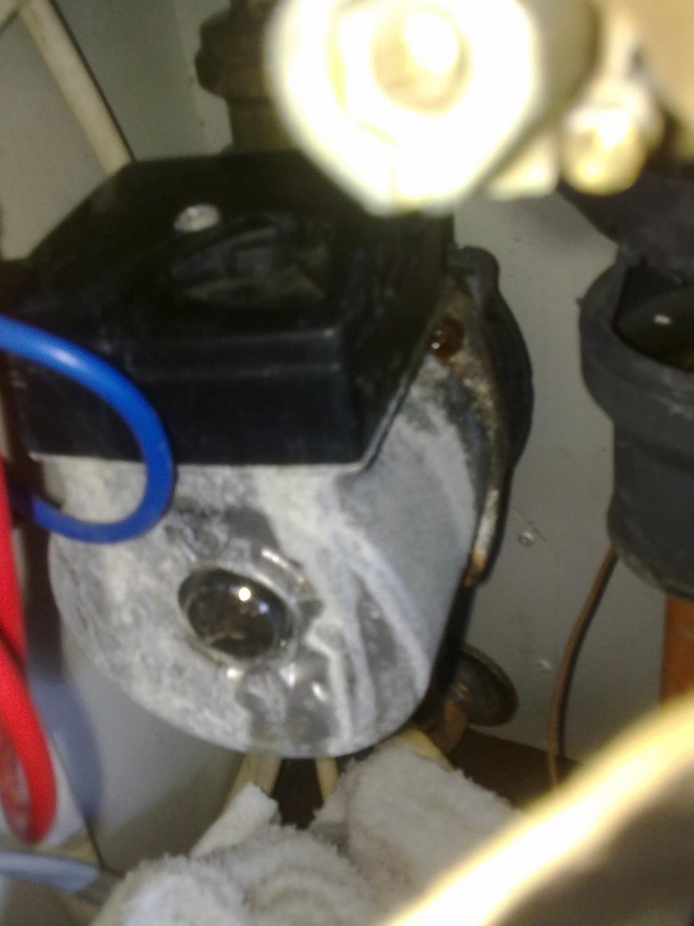

went and seen boiler today, pumps running, stats ok, at first it seemed all 3 pumps were running but it was just the vibration through the pipes. I checked the temperature of the Primary Heat Exchanger and it was at 85 degrees, boiler pump showing signs of corrosion, AAV leaking, pump valves leaking. I have 240v at the boiler pump, resistance is 180. I'm thinking its the pump, what do you guys think ?

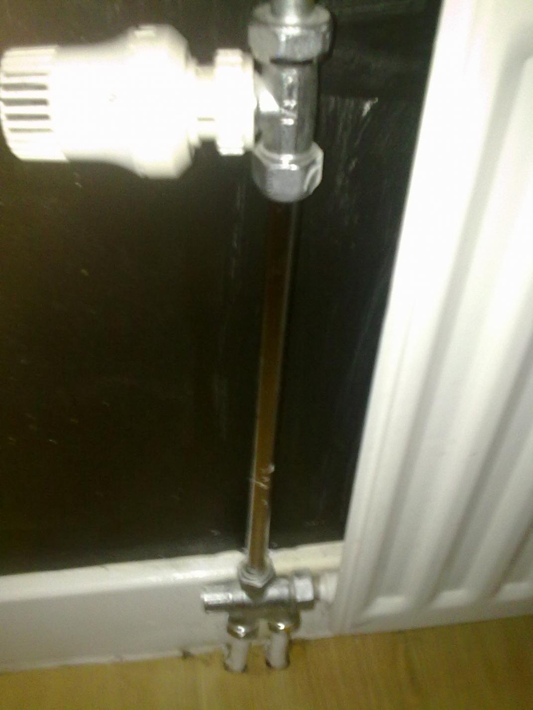

this is in a rented apartment in town, so i don't think company will want to pay for powerflush, if they do, how troublesome will it be to do it on these rads ?
does anyone think this could be the problem ? when i opened the bleed screw on the pump luke warm water came out so the store must be up to temp. There was no power to the PHE pump is this the pump that circulates the store water and not the boiler pump ? it looks fairly new where the one in the picture looks knackered.
When a pump goes on an electra mate, it will often take the PCB with it.

Control board failure can also be caused by pump failure or water ingress from a leak into a (still working) pump motor. In this situation fitting a new board without replacing the pump motor usually results in the new board failing too. The best defence for an engineer is to measure the input resistance of the three pumps and to visually inspect each of them for any evidence of water contamination. If any pump has a resistance of less than 160 Ohms or has any sign of water marks or corrosion around the connection box on the motor, I strongly advise replacing it even if the pump still works.

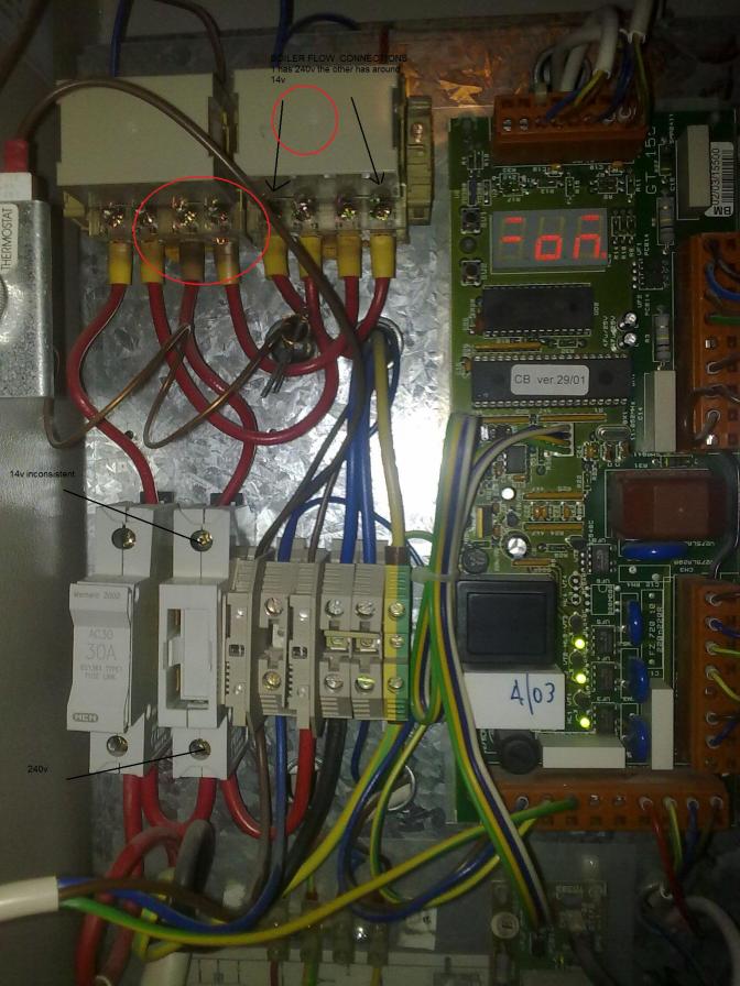

well seems i was wide off the mark, i misread the data and thought the store was at 85, its actually at 20 degrees, had techincal to talk to today as last night it was 6pm, he reckons its the boiler flow. I am getting power to the boiler flow, boiler pumps running, continuity at all stats, power to heating pump, I'm going to replace the boiler flow and relay, and get new fuses for the ones that are missing.

you cant really make out the writing but the red circle shows scorched wires, the 2 red wires are the boiler flow connections one has 240v present the other around approx 14v, 30amp fuse has 240v at both ends and at the relay, the other one which doesnt have the fuses has 240v supply and approx 14v out.
