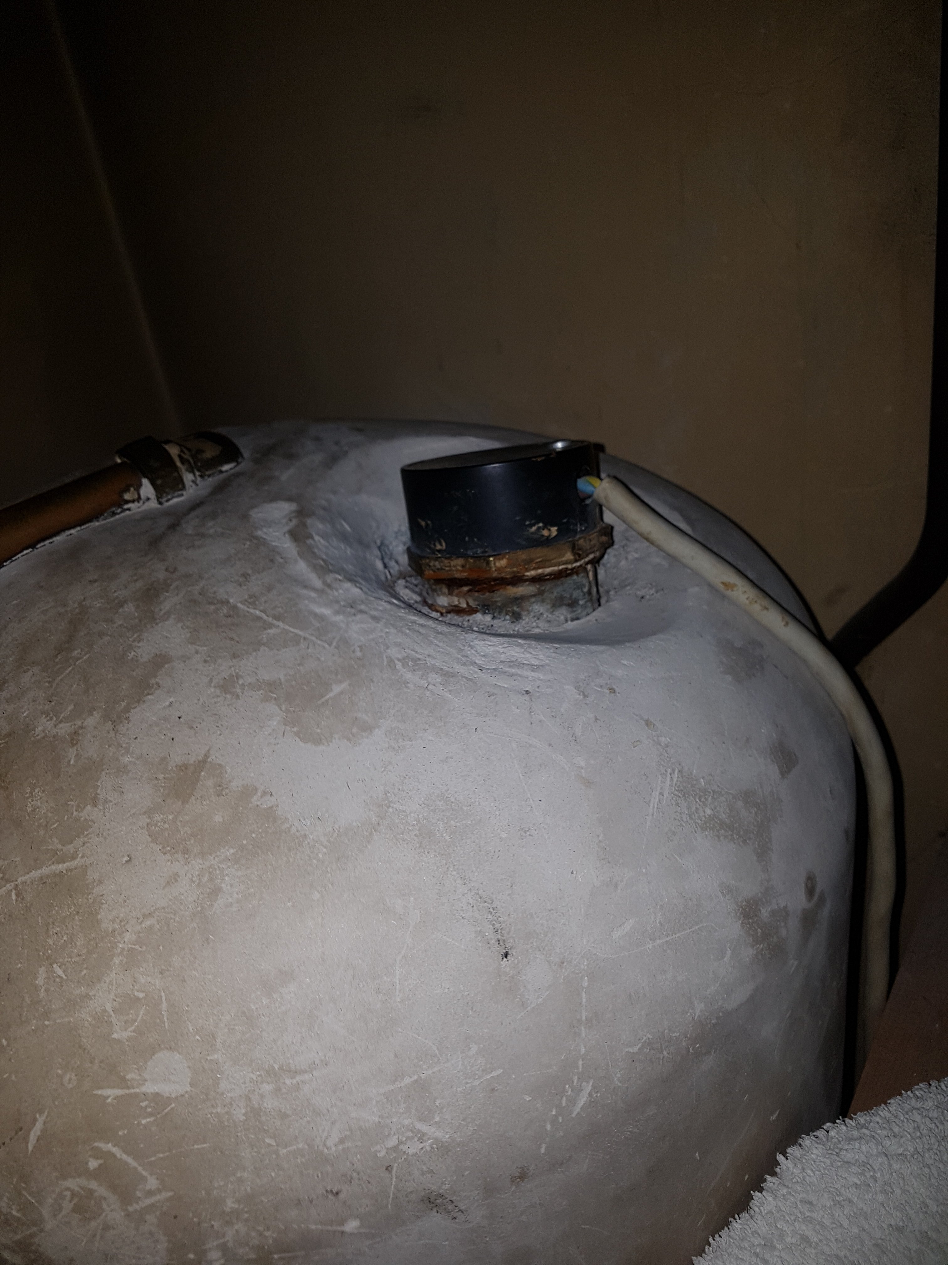

Top of the cylinder is a pain and is 20 inches below ceiling slab as cylinder is raised off the floor.
I was going to use this set up. Probably insane but is it a possibility?setup.jpg Pipe on the left of the set up to go into the cylinder is this one:
Connection would be in this handy area place for flange.jpg just below the seam.
Don't mind drilling the hole. Only concern is the compression fittiing on the inside. Is it doable, possible, madness??
