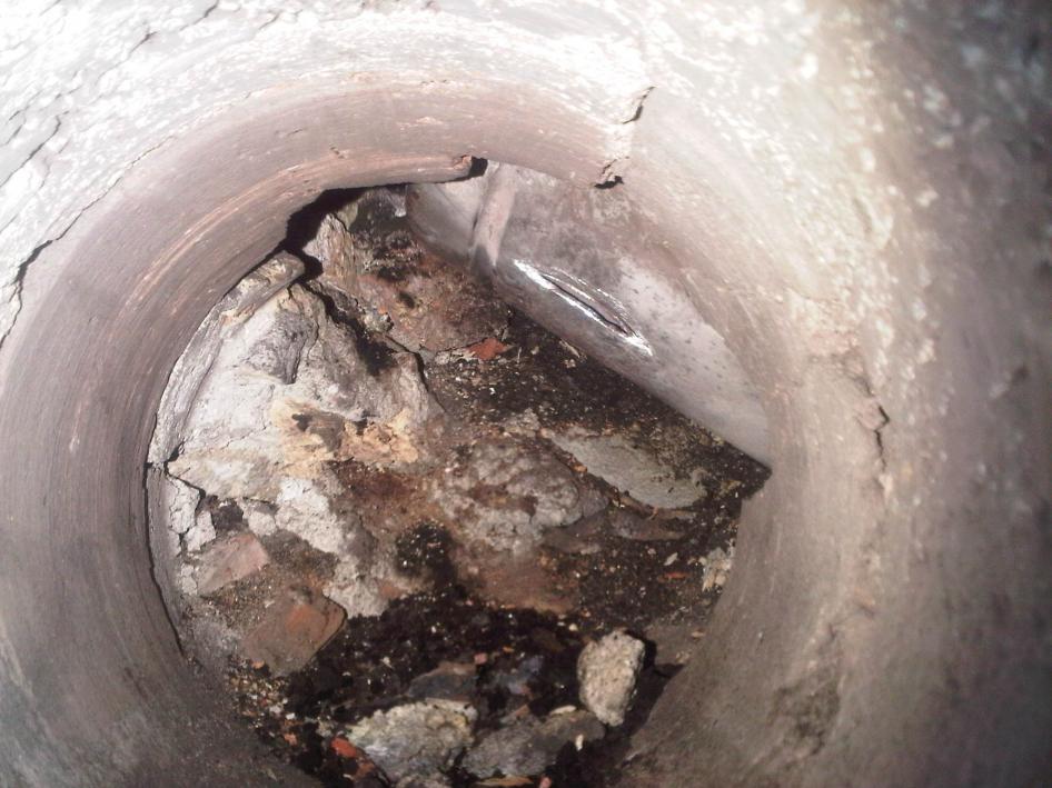

Funnily enough I went to a job today with an unlined stack, the end of the flue going into the stack. the stack crumbled internally. This is looking horizontally into the stack.

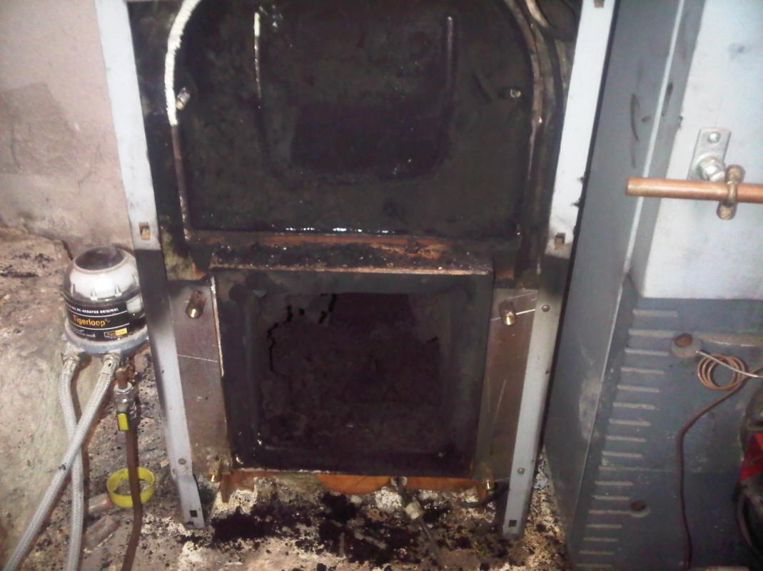

It did this to the boiler.....
