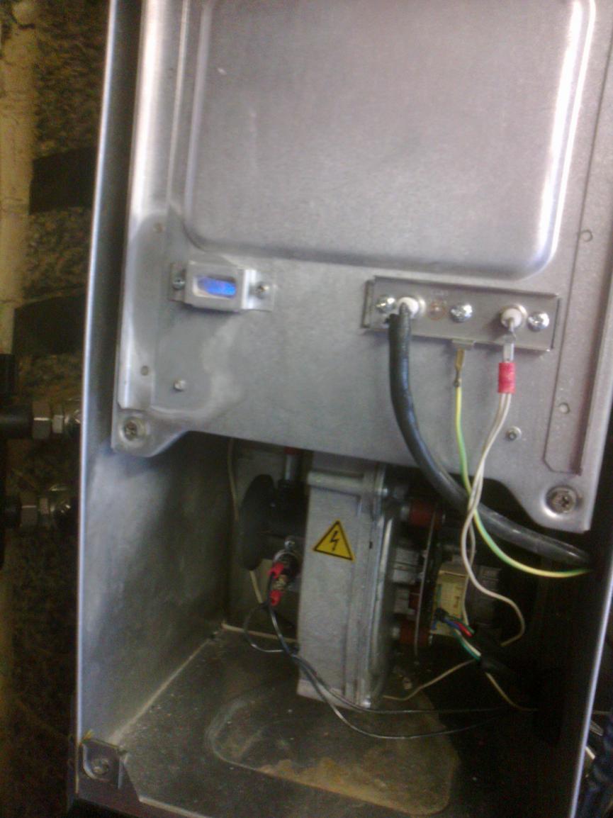

horrid boiler - electrodes and lead can be troublesome also check the door seals and the burner these are known to come apart and can melt the boiler

Go on!! live a little fella it's Saturday night try it out!!
Sorry feller, I wasn't brave enough to have a go. Especially on a saturday night. The wife goes nuts when ever I start stripping things at the weekends. They usually end up going from bad to worse!

So I tried it with the case off today. Still exploding! So phoned baxi, he got me to check gas valve. The 1st 2 pins on the left were 3.5k ohms when they should be 1.5. So he believes it is letting too much gas pass. Need a new valve apparently.
Jusy bought myself a gas valve and now I csnnot get to the nuts to take it out. It says in the book the valve comes with a service spanner but it don't. What do you guys use?
I tried with grips and all kinds of spanners but no joy. I cannot believe in 2 weeks I have bought parts with the sockets that they're supposed to come with missing:-(
I tried my mini socket set but couldn't get it between casing above and nut. I can get the one at the front, but the 2 at the back are being troublesome
