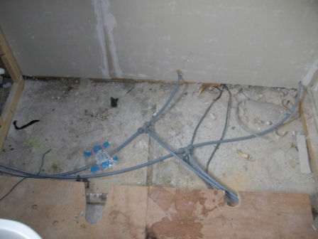

going into this space . you'll see where the cutouts are, those are where the 2 legs stand.

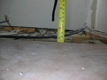

as you'll see, the floor is cast concrete, and the surface for tiling is 25mm WBP, on battons. this gives a height of 65mm from the concrete.
Now, add tiles onto it, 6mm+grout, so call it 8mm ( is 2mm enough ?) and its 73mm. remember that number.

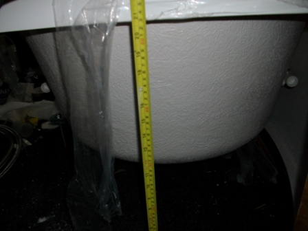

here's the legs on my bath, fully extended.

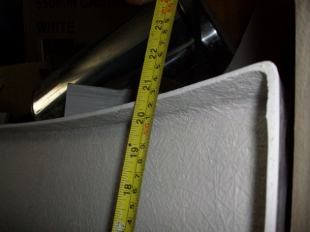

that gives a height of 53cm for the edge of the bath rim
handy then, that the path panel is : u guessed it, 53cm tall
So, in order to get the panel to fit without cutting it ( not an option) i need to raise the bath off the floor by 73mm, give or take. its likely to be 75 then drop the legs by 3mm.

The panel is "u" shaped, see the last photo, thats the panel. That little 2 inch angled peice is at the top AND the bottom of the panel.
there is little sping clamps that grab it when the panel is pushed in.....so if i cut it, there will be nothing to hold it.
I did consider cutting it, and then screwing it to a peice of CLS behind it - it'll look rough though.
Besides, chances of getting a GREAT finish on a cut that long. it'll meet the floor, and black shiny tiles.....so any flaw will be obvious ( to me at least)

Cast concrete HOUSE - so that floor is the "roof" to my downstairs. Hence all my wiring and plumbing/central heating is in that gap between the concrete and the ply.
