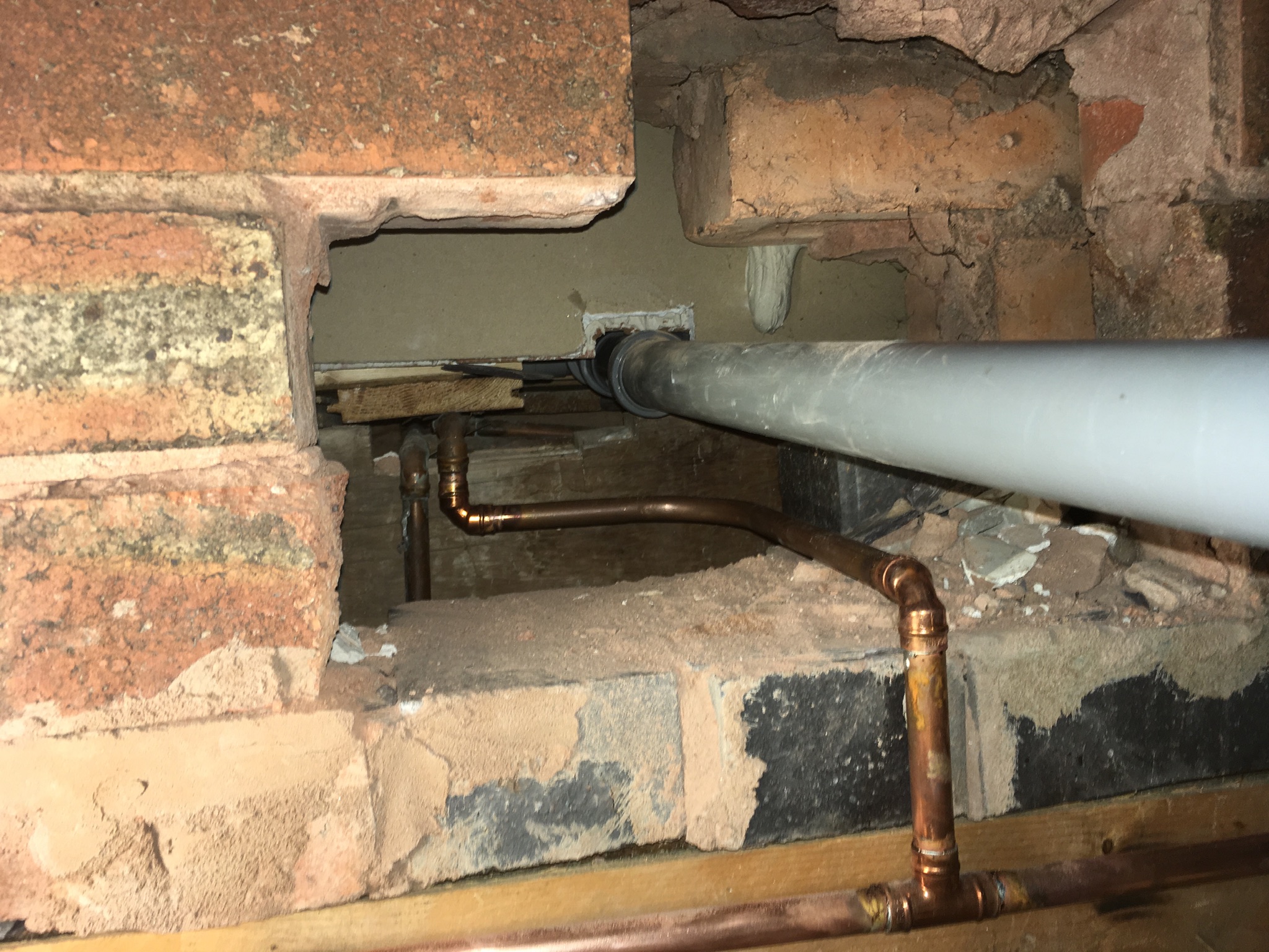

Some pix, the first is the only place where pipes were accessible, lookin from loft through hole in cavity.

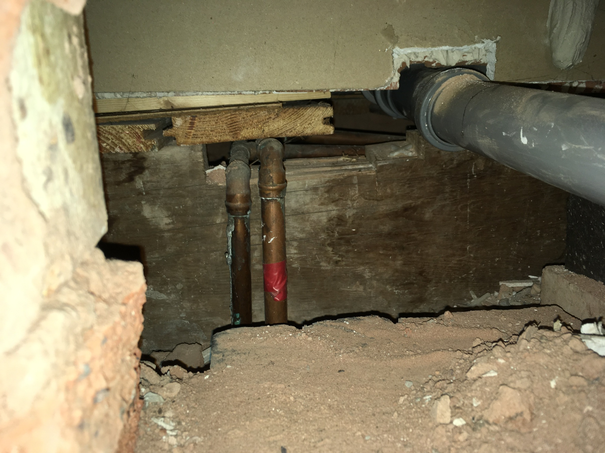

This is the re routed hot water
Still got to block up the holes in the brickwork as I am not happy with it re. Fire safety.

Soil pipe is bath waste! I had get over it to go further down the loft.
