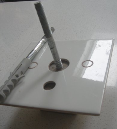

And if the floor is tiled and you want to get through it with an anchor bolt then we suggest removing a core from the tile with our diamond drill bits first.
You can then drill through the fitted tile and into the concrete to fix your anchor. We did this recently at an airport where they wanted to bolt down a cash point terminal without disturbing the tiles.
The anchor bolt (on the left shown fitted into its 14mm rawl plug) can be fitted through a tile into a concrete floor.
I know this post is about drilling concrete floors to fit a bath so I just thought I would add our expertise if other readers of this post wanted to do the same but the floor had been pretiled.
