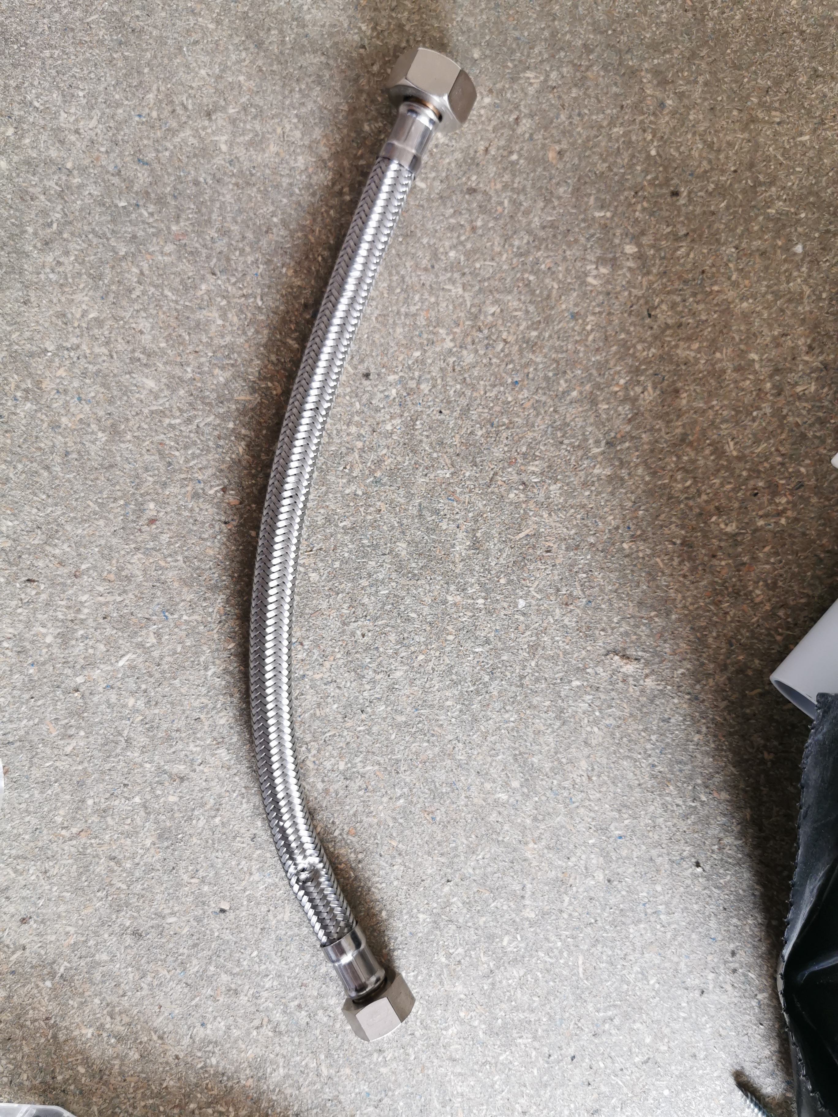

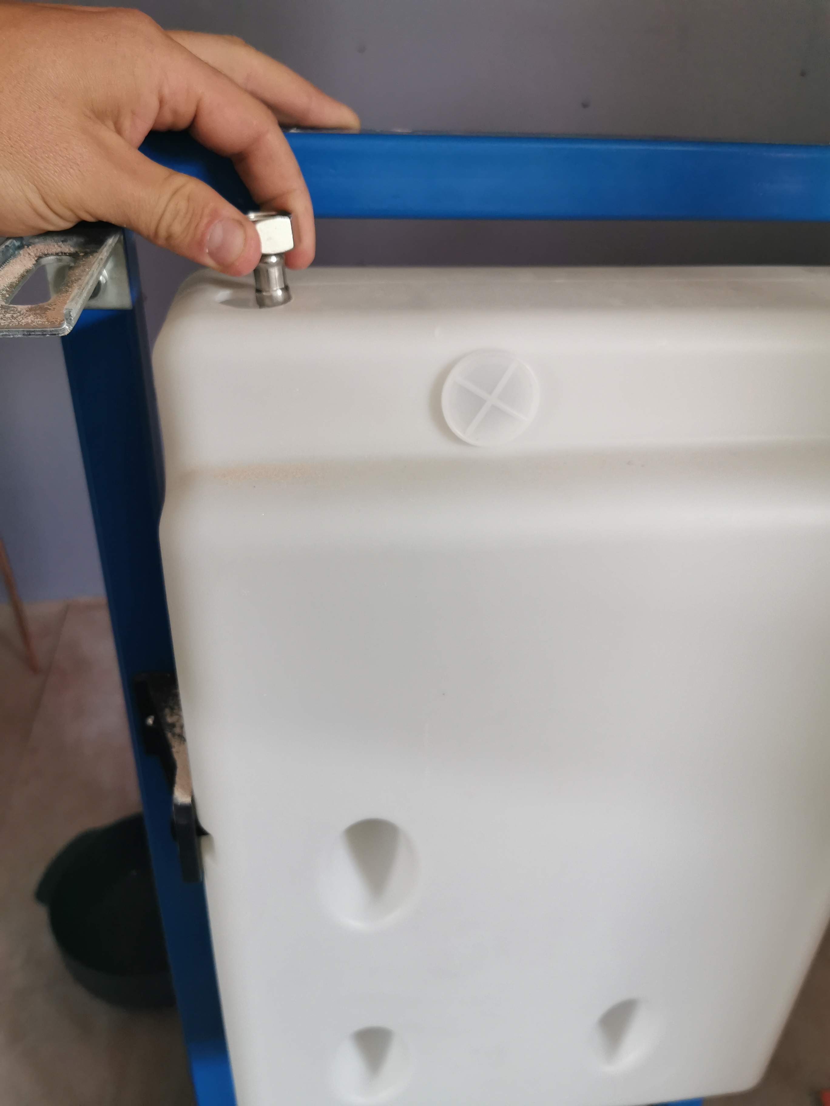

I am trying to fit a wall hung toilet in our new en suite.
The flexible hose within the cistern is only just long enough to exit the hole in the cistern which means the final connection will be very awkward.
The flexible hose is female BSP both ends. One end is 1/2" to fit onto a 15mm isolating valve and I'm guessing the other end is 3/8" but I'm unsure all I know is it is smaller.
I don't seem to be able to find any replacement hoses in 500mm length.
Any help much aporeciated.

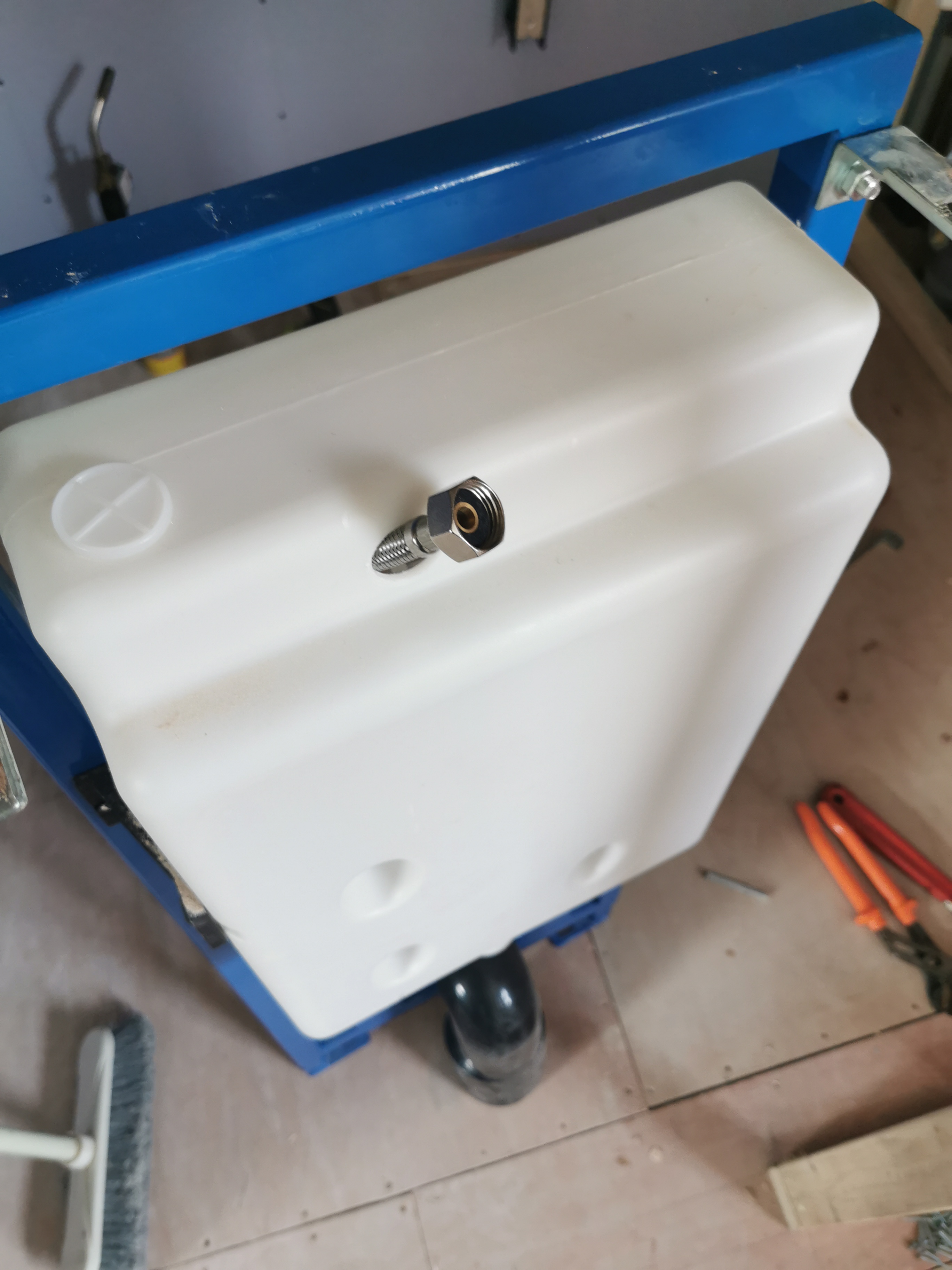

obviously yours maybe different but every wall hung toilet iv done the flexy hose in the cistern stays in the cistern and threads on/in to there 90 degree shutoff valve which goes into the "hole" your talking about and then to the float valve ,
I could extend the copper to the hose but it will just be awkward to connect.
If I could get a 500mm version of the hose that would be perfect.
Ok that maybe an idea. I guess if the copper goes into the cistern then it can be isolated through the push button.
I think that maybe the easiest way.
no thats gash , you should have a 90 degree shut off valve that bolts/clamps into that hole , some times there packed up tightly inside the flush pipe??? what brand toilet is that?
  • Agree
Thanks for the video link. Yeah that makes sense now.
I didn't get anything like that in the box so may have to make a phone call.
Thanks again for the help.

Nothing wrong with a good quality flexi properly installed. Wouldn't use the one in the picture as it's been kinked.

The video has cleared it up now so I think I'm missing a part from the kit.
