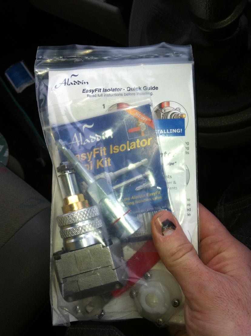

What happens to the pipe when installing the Aladdin EasyFit Isolator?
The Aladdin EasyFit Isolator cutter plug has a blade attached to the base which slices through the pipe. The blade has no teeth, instead it is scalloped in order to avoid swarf. The copper or plastic pipe slug is simply compressed into a sealed void at the bottom of the housing.
What the hell have you done to your thumb?
You know I was giving someone advice earlier that in domestic plumbing you should never have to graunch something with all your might?
Well I should take my own advice.
Repaired a boiler. Which had a faulty divertor motor due to the leaking heat exchanger above it.
So I change the divertor, and set about fixing the leak. I tighten the nut on the heat ex'. Still dripping. So I tighten it hard, the spanner slips, and crushes my thumb against the heat ex'.....I swear. A lot.
All this was being done in the pitch dark, as the customer has a key card electricity meter, which had run out in between me diagnosing the fault and returning with the part. So I had to pop back the next day to check the repair had worked!! LOL.
So I'm blaming the dark.
As a helpful hint for everyone else. The rubber washer that I was tightening the nut on to had gone bullet hard, so no amount of graunching with the spanner was going to stop the leak. In the end, I isolated and drained the boiler and replaced the washer. Took about 10 mins. Had I done that in the first place, I would still have a thumb nail!
You live and you learn!! 🙂
