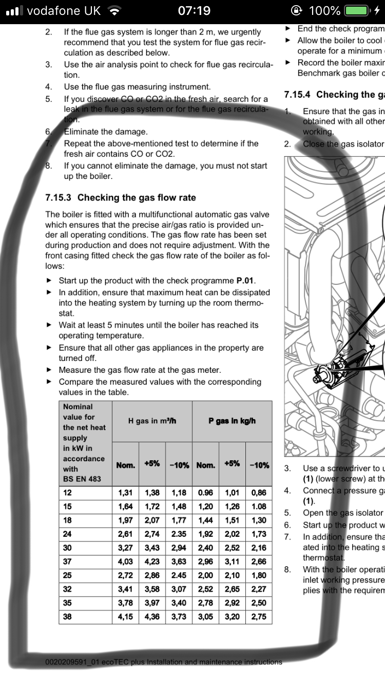

Also @ShaunCorbs & @firemant isnt what you are both describing a KW rating and not a gas rating. A gas rating for a 30kw boiler is about 3.2kw not 30kw? Or am I missing something here?
I don't quite understand your post, HF.
Probably strictly speaking, a gas rate would be measured in M3 but after saying Kw is not a gas rating, you go onto suggest it is.
A 30Kw boiler will be typically about 31/32Kw input, not 3.2. was that a typo?
I mean that this is a gas rate mate
Ok mate. That would be good as when I was being taught on and off the job. The chart above was referred to as a gas rate.
